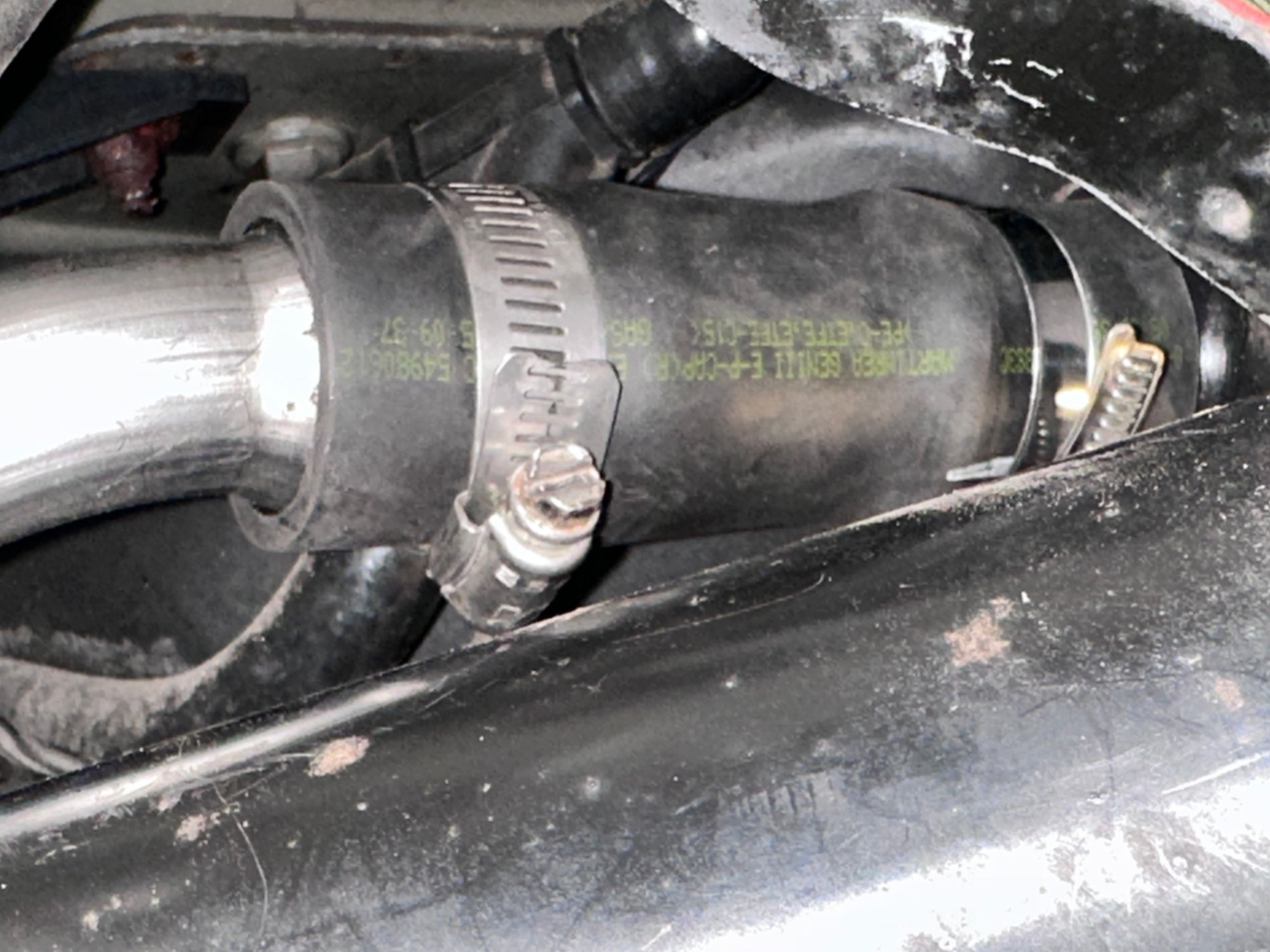

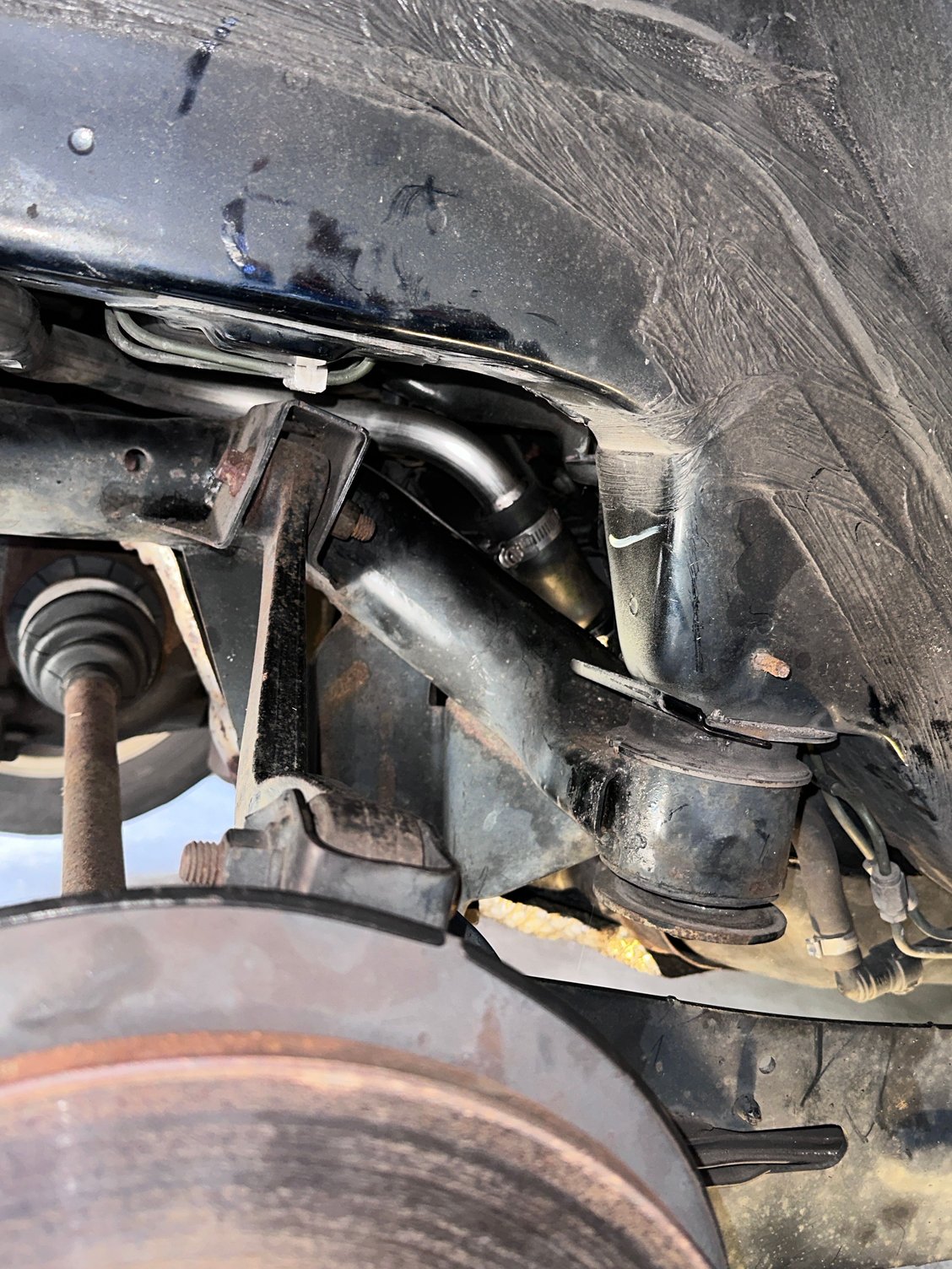

Wondering if anyone knows how to replace it? Tried removing the rear shock with an impact- no joy. Will saturate with a penetrant & try tomorrow.
Even if I remove the shock, still won't be able to pull the tube out, but will be able to get my hand in there.
Even though I removed the 3 nuts securing the tube, the tube is in-between parts of the undercarriage.
Got the last fuel filler pipe to tank hose from SNG Barrett. Told me it was the last one in the UK.
Part number is P_C2S33826 Price is $50.58.
It's a short piece of 1.25" fuel-rated hose. Advance Auto has a Gates hose, however they say it's has metal threads- not nylon. So it's impossible to
bend. Will provide a part number tomorrow.

After removing the the rear shock & removing the 3 nuts securing the filler tube, was able to install the short fuel hose.
What made it easier was spraying the inside of the hose with silicone. Permitted twisting the hose down on the fuel tank opening.
