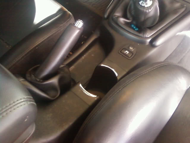

Hey guys, if you look on the picture, you will notice on the right side, the top left spring is missing, I think its gone inside somehow. Does anybody know how I can open the cupholder and fix it..?

It's not a spring actually. Do you really want to know how that works? The cup holder and its cup retaing tabs are wrapped with a rubber band. If only one isn't working and the other three are i would suspect that the nonfunctioning one is broken. May be worth taking apart to see if perhaps it just came off.

Sidewalk man is correct, the console must be removed. Torx screws under mat in cubby, torx screws under j-gate veneer, torx screws behind side carpet panels, carpet panels held with 1 pozidriv screw near j-gate and then friction clips. 20 minutes if you know what your doing tops.

To be honest i didn't get any kind of picture in my head on what you just said. Could I not just somehow lift the chrome ring around the cupholder..?

The cupholder is attached to the bottom of the console, if you pry on the chrome ring it will just break. Open console lid, remove junk from inside console, see rubber mat on bottom, remove mat to expose 3 torx screws. Look at carpeted panels between seats and center console near the j-gate and you will see 1 black pozidriv screw in each panel, remove these screws and pull carpet panels off. This will expose torx screws going through the console to the metal bracket attahed to floor, remove these screws. If auto trans open ashtray and pull up on j-gate veneer trim to remove, if manual trans just pull up on shifter surround anywhere. This will expose 2 more torx screws going down through console into metal bracket, remove those. Console is now free, lift from rear, disconnect dsc button if fitted, remove console and inspect cupholder.
