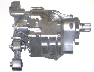

A problem on early models is the transfer case. Later models (2005 I believe) have an electronic DSC system so they have no viscous coupling in the transfer case. There'll be a DSC light on the tunnel. That would be a better choice.

DSC was always an option on X Type.....For your wife, do not buy a 2004 or newer without DCS....positively dangerous, (false sense of security without DSC) on slush, ice,and very, very wet roads (pretty OK on fresh light snow), unless you are good at sensing every tiny "twitch" of the car. The 2002 and 2003 have the viscous coupling and can get by without the DSC but many do have DSC option. So if you find a 2002 or 2003 without DSC then you really need to know if it still has the viscous coupling transfer case...if it has been replaced with a "new" one it probably would not have been a viscous coupling unit....the two types of TC are interchangeable. Both types of transfer cases are prone to failure but not the same types of failure in general. Both will fail in short order if you "floor" it through the red line in all gears too often.
