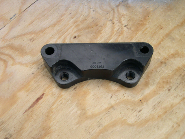

If you know anybody that's halfway decent with CAD you could probably measure up the brackets you'd need and upload a CAD image of them to emachineshop.com. It would most likely cost quite a bit less than taking it to somebody else. Things you'd have to look out for is the centerbore and brake line attachments. Most of the rotors I've been looking at for the X-Type are much larger than the 63.5mm centerbore which might lead to some wobbly action of the rotor. As long as the rotor fits tight against the studs it should be ok. If I wasn't so funds challenged right now I'd be doing just that in anticipation of the next racing season but alas, I'm broke. LOL
Anyway, I've attached an image of pretty much what the bracket _could_ look like, this is the exact bracket setup I had to put on my SVT Contour when I fitted 13" Cobra brakes and the twin piston PBR calipers.

Send me a sketch with dimensions (sizes) and I will draw it up in CAD or model it in 3D.
