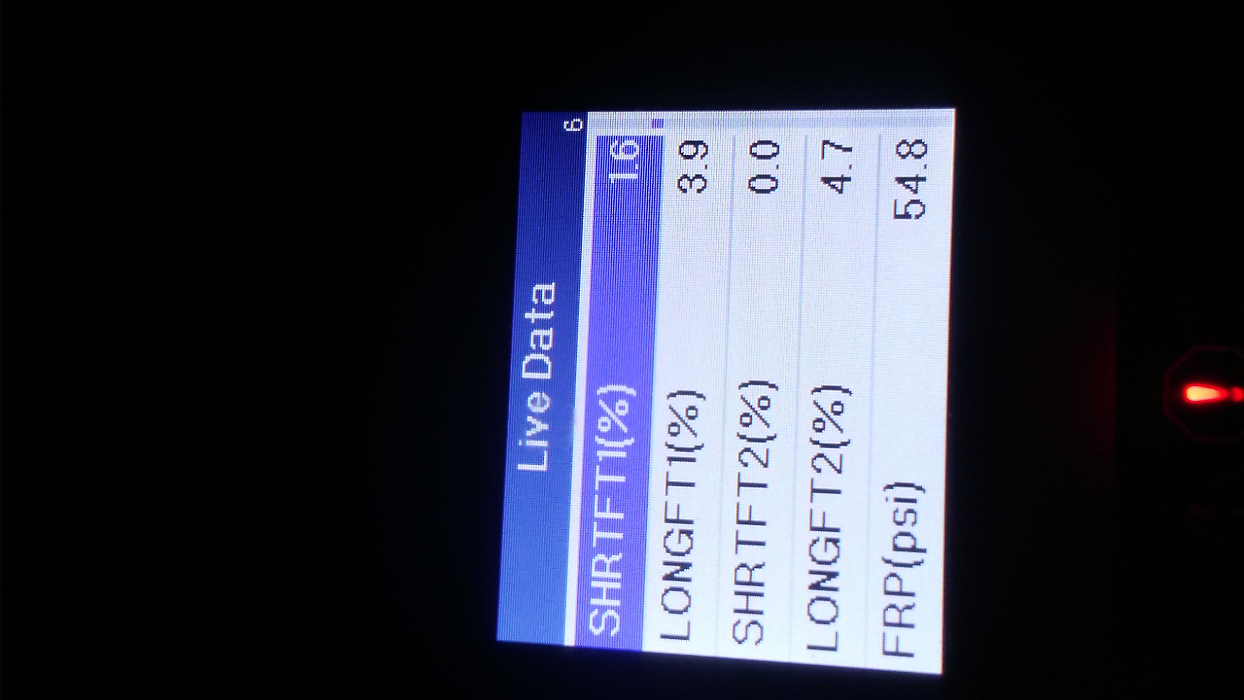

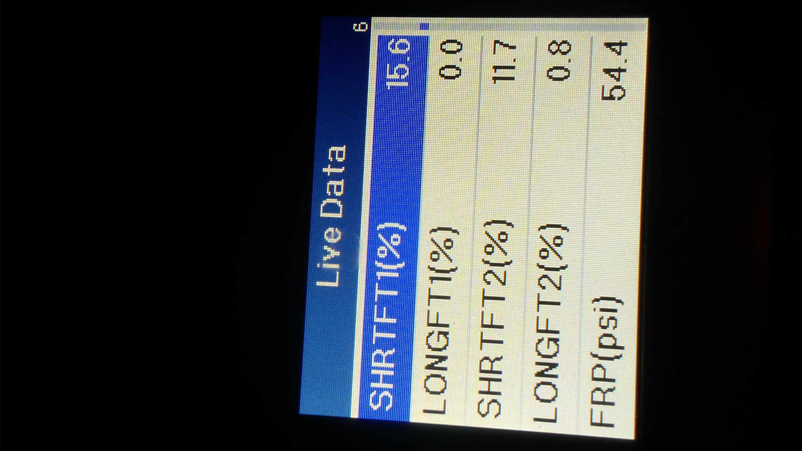

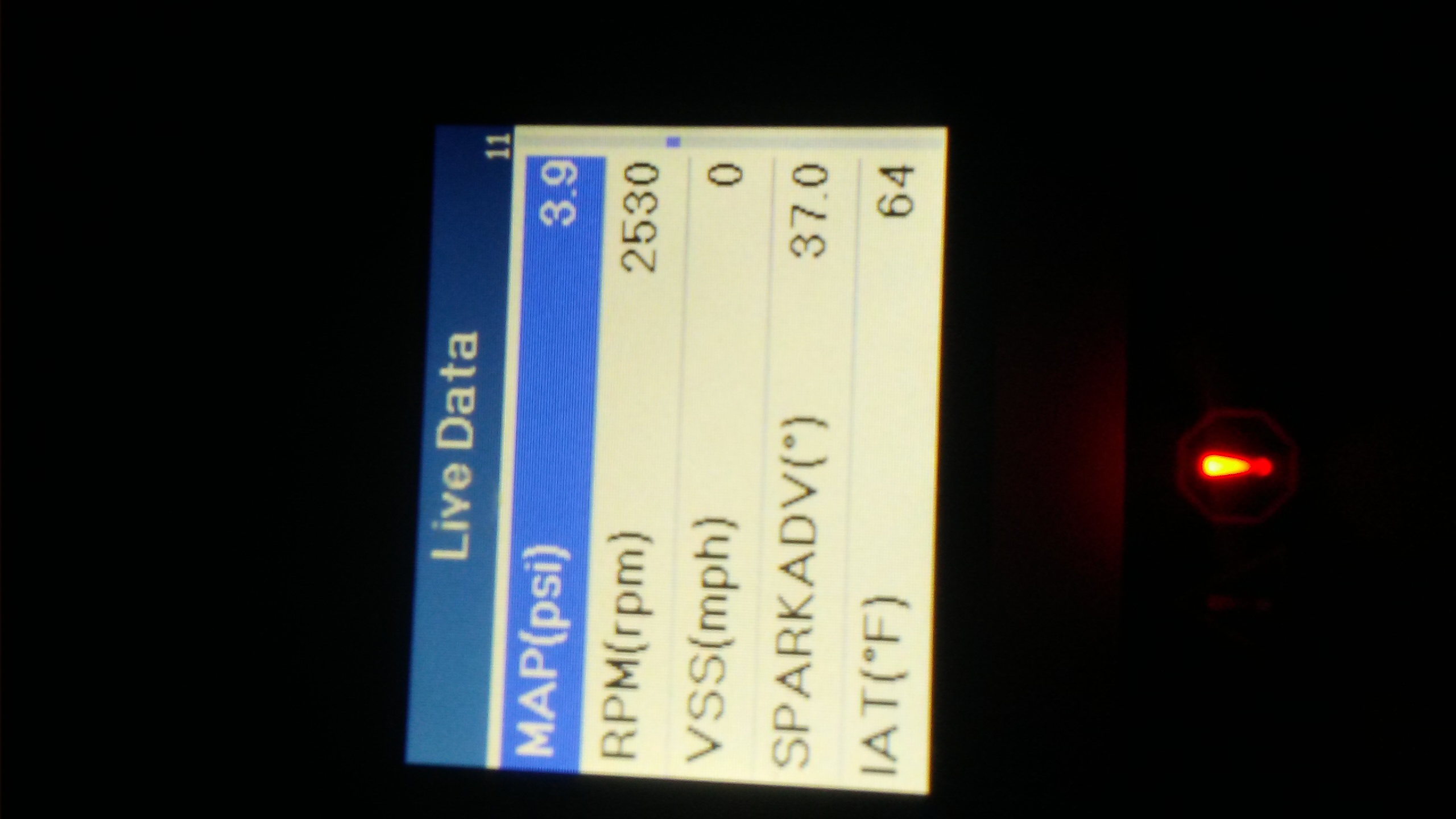

Ok so I redid this test with the STFT closer to the proper parameters i.e. finished learning. Attached are the fuel trims at idle and 2500 rpm respectively. Could this be being caused by an exhaust leak? I am 99.9 percent sure I have one. I run the heater and it smells like something burning.

Old Mar 7, 2018 | 01:35 AM
JagV8's Avatar
Posts: 27,546
Likes: 4,924
From: Yorkshire, England
Would be a very small one, but could be.
