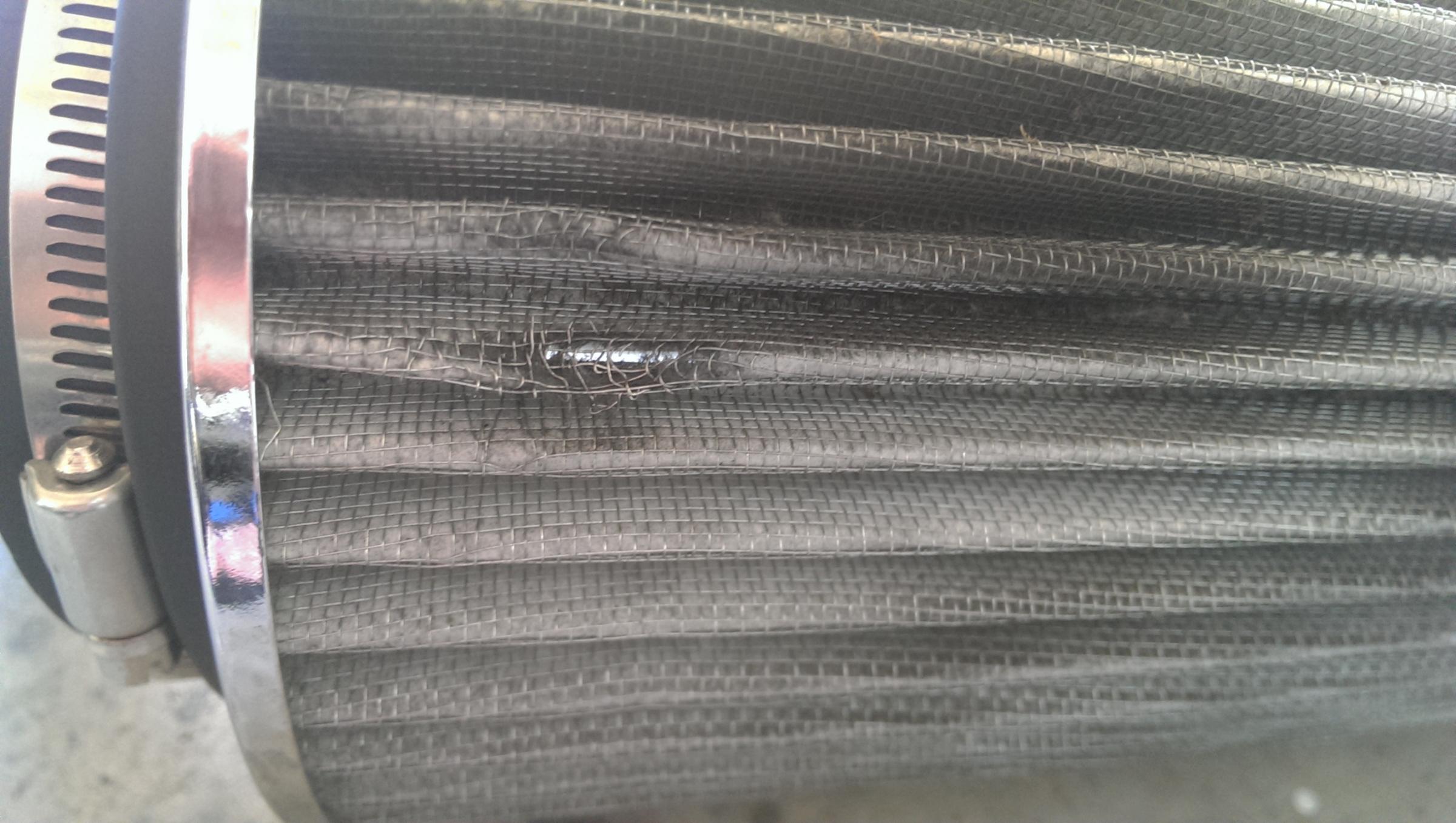

Hi guys,
I've had the ram air intake that exexpat introduced to many of us for some time now and I took it off to inspect it and it seems like it's been slightly burning... I attached a picture of an area where there's actually a hole in the filter. There are a couple of these on the filter.
Has this happened to any of you guys? I immediately reverted to the stock intake but I want the ram air back. I was thinking of trying the AEM DryFlow cone filter. Is it possible to fit this filter into the bottom half of the stock airbox to provide some insulation and protection?

Here's the pic

ez, based on the picture, it looks like the filter is rubbing up against something and that is what is causing the hole to be formed in the filter.
I am running the stock air box, but I am using the K&N filter in the box. Unless you have opened up the exhaust, opening up the intake is going to net you very little other than looks. If that is what you are after, then great. But, don't be looking for any performance gains.

That does look more like a rubbed hole rather than a burn. I haven't noticed anything on my intake (I have the same setup) but I haven't looked at it in a while.

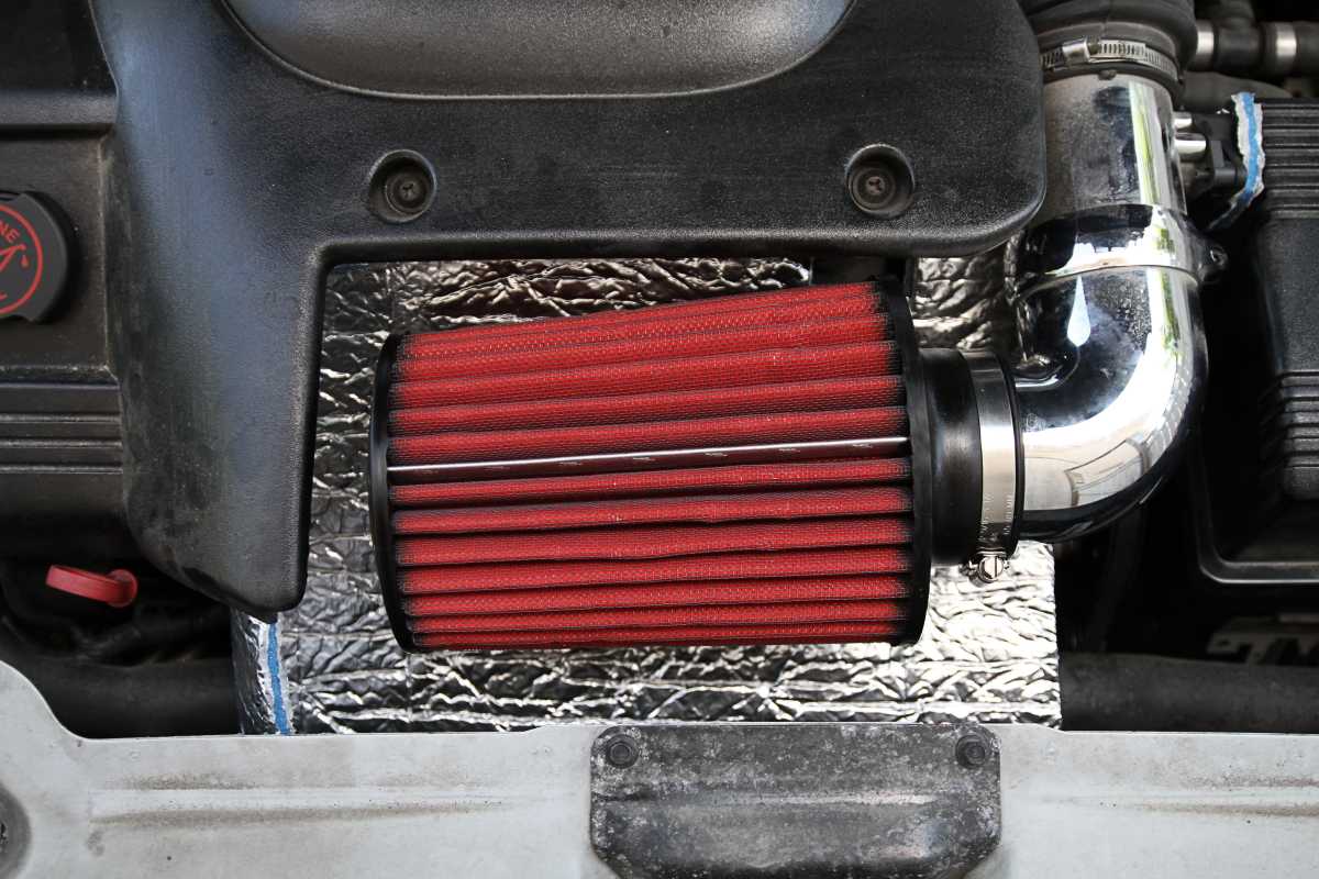

My first AEM DryFlow got rubbed too, and it was a bit too long anyway and the end rubbed against the engine cover as well.
When I fitted a new one, I also fashioned a sort of heat shield out of fireproof alloy-foil thermal insulation mat. It blocks airflow from underneath the engine cover and also prevents the filter from rubbing against anything harmful.

thermo, i do have 3 inch piping, no resonator, and magnaflow mufflers. but i didn't do the intake for performance at all. not even looks. it's purely for sound! also, i haven't heard good things about K&N filters, i hear they aren't very good at actually filtering. do you trust them?
also, i assure all of you the filter is pretty blackened on the bottom side so it's probably some sort of combination of rubbing against something and burning up.

aonsaithya, where did you get that insulation mat and how exactly did you install it?

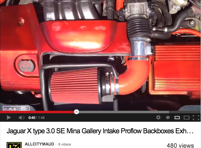

Here's a screenshot from a youtube video i just found with some sort of insulation around the cone filter. this is exactly what i want! i've seen it on a few different cars. did mina gallery used to sell it? anyone have any info on this?

Nyces from the UK forum is behind the video that is indeed the Mina Gallery kit. Their first kit had some issues, then they revised it a few times, then took some time and released that which is apparently the 5th version.
and for anyone who can answer: does anyone have experience cutting out a part from the stock airbox to fit the big 9 or 10 inch cone filter into the box? i feel that'd make the most sense.
Added a photo to the post, I apparently forgot it at first. It's still in my signature too though. The mat I used is Aluthermo Quattro. I cut the pieces to shape and made a few holes, and the engine cover mounting bracket mounting bolts go through them.
I tried to fit the larger AEM cone I had earlier (21-2039DK so 9" long), but it was far from fitting in the airbox. To give a sense, look at my current photo, the 9" long filter pressed against the engine cover on the left side of the cone. The current one is 21-2038DK, 8" long.
