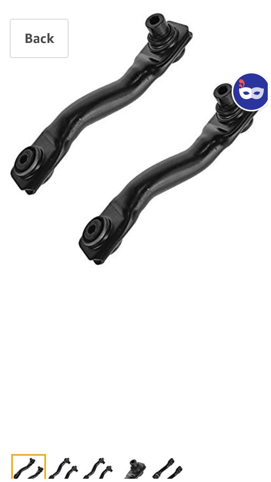

I'm with Alpha, rear front lower control arms

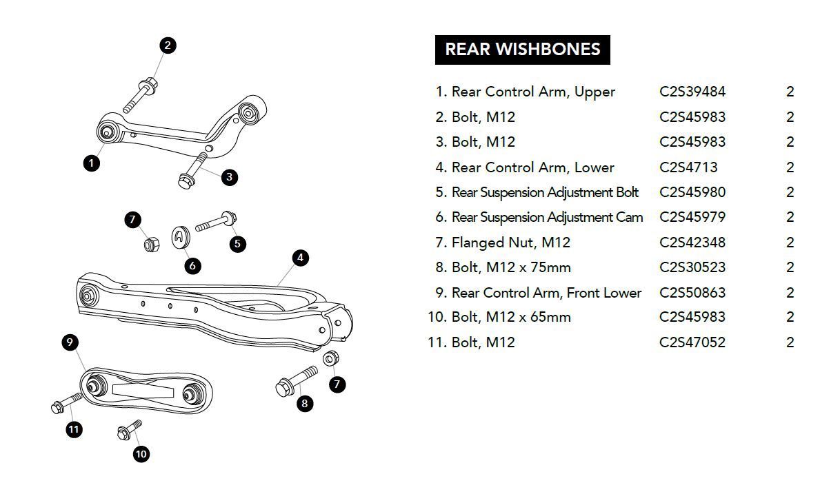

This is #4 you are talking about, right? Just because #9 has a very similar name :s Sorry for the noob question.

#9 = Just heed that if/when you replace them, do not torque fully until the car is sitting with full vehicle weight on the ground.
