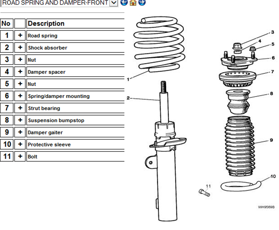

So right now I have 6, 8, 9 and 11. What is part #10? I can't seem to find it what it is.

Spike, what drawing/picture are you referring to? I am not sure what Part 10 is?

Are the numbers you reference from this Jaguar EPC front strut diagram:
If 'yes', seriously consider replacing the strut bearings - #7. Old strut bearings could cause the clunk noise you hear when you turn the steering wheel. The entire strut assembly pivots on the strut bearings when you turn the front wheels to the left & right.
#10 is a rubber sleeve to prevent squeaks when the coil spring flexes against the strut. Google part # C2S12028. I simply reused mine as they seemed in good shape even after 100K miles.

Number 10 on this diagram.

Second, I was referring to number 10 from the diagram I posted above

Spike, 10 is the strut bearing assembly itself. You may have gotten it when you got your piece 11. The easiest way to tell is to look at the very top piece (#11) and does it have a collar on it that twists left and right? If yes, then you have the bearing too (ie, #10).

Part #10 is the strut bearing. When you replace the struts, I'd definitely replace these, along with the strut mounts. The strut bearings are physically sandwiched between the strut and the strut mount, so they take a hit on every pothole, literally. And when you turn the front wheels left & right, the entire weight of the car's front end pivots on the strut bearings.

Mark: It was good meeting you and test driving your X-Type. The noise we heard from your front suspension I believe is a worn strut bearing that caused the clunk noise when we turned the front tires lock-to-lock.
