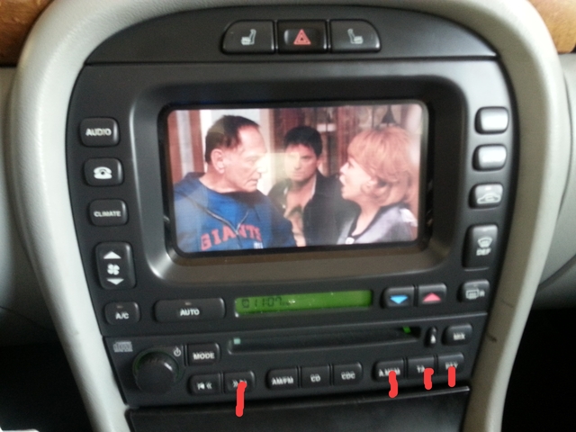

on your deck press the seek button and one of the other buttons marked i cant remember which one but its one of then in the pic
next phase will be software and driver

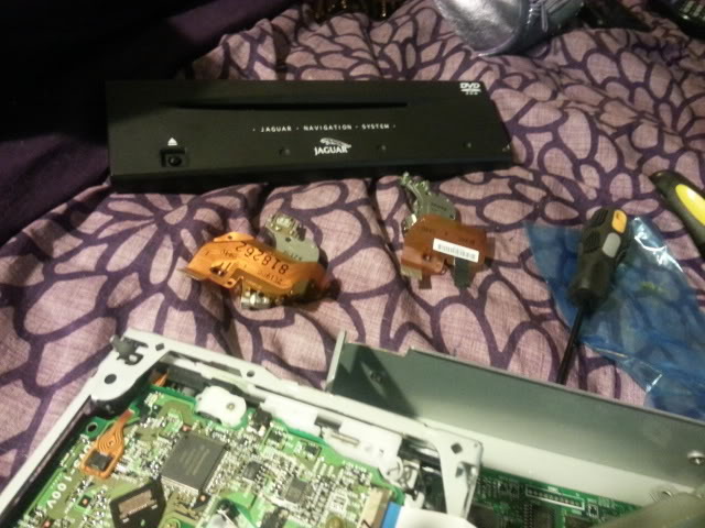

alot of times if you find a dvd rom on ebay it will have the disc in and fix the problem but sometimes the rom you buy has the black screen to,if you get the right loading file then your map disc 80% the time it will work
now ive repaired a few roms and got them working

now if i had no knowledge on files and software and gadgets
i would take my chances with a dvd rom reader on ebay

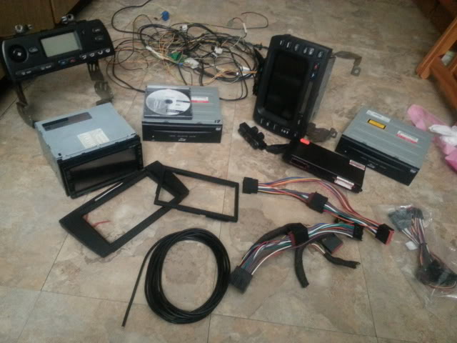

take a look at my sat nav with all the bells and whistles

Originally Posted by dennis black
no problem happy to help,
JAGUAR X-TYPE CUSTOM MULTIMEDIA SET UP ANDROID NAVTOOL PART2 - YouTube
Spill !! How did you manage to do all this. I was wondering how to get the tv part to work. My sat nav post codes doesn't work either. I am also unsure how to get the phone part of it working. Been in the 1971 menu and can see how to enable them but not sure of much else.
