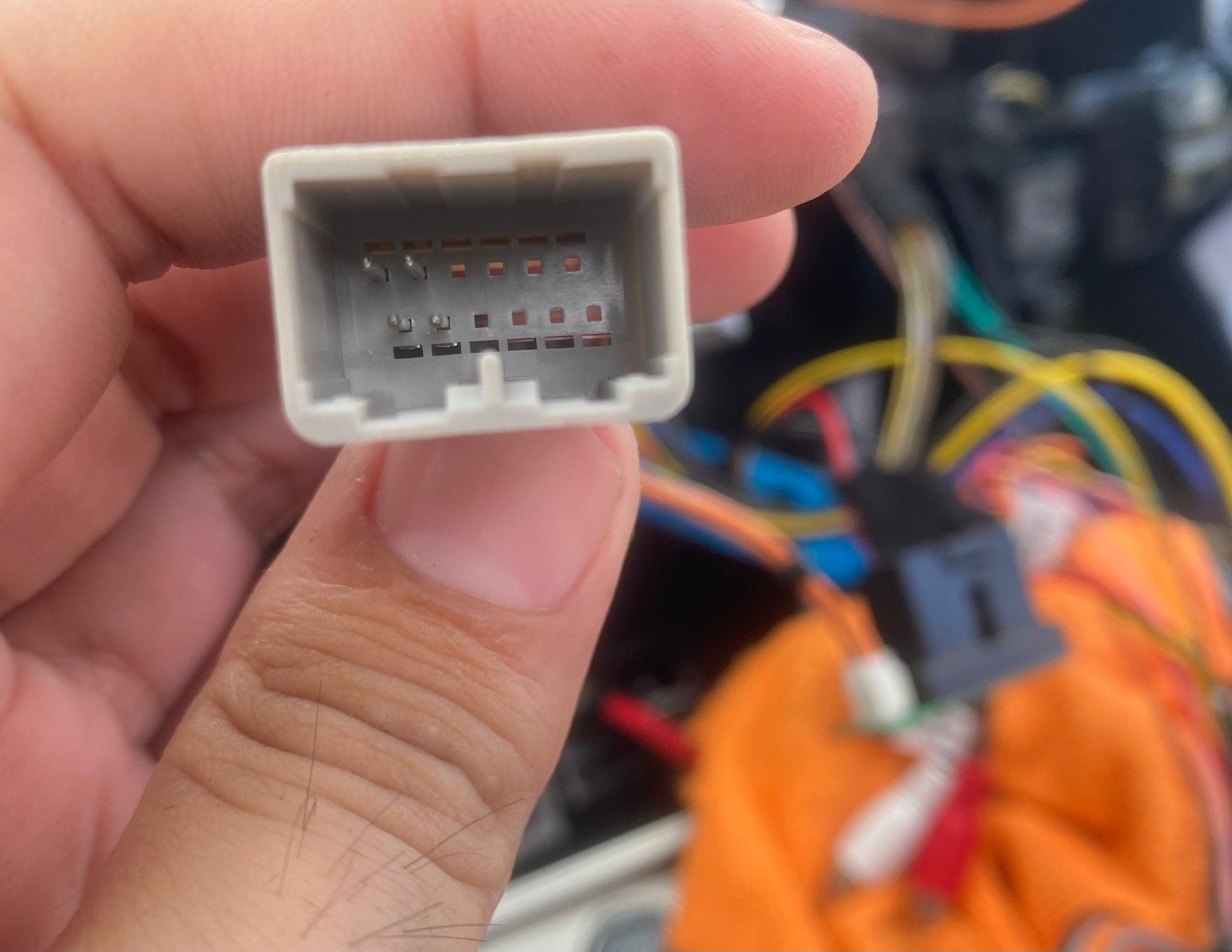

Emergency lights adapter
So I recently bought the 10’ from AliExpress and it all seemed pretty much plug and play. I did have a few weird lights popping up at first and it did kill my battery on install but all seems to have stabled out now. In the last week or so no problems EXCEPT this damn emergency lights and door locks. My problem is that I used the conversion adapter (I have a 2011 xf) so I need one of these but with both sides having the little 4 prong one. Anyone know where I can get one or the exact name of it? Also Dennis anyway I can get that jag png? My photo editing skills really suck hehe
Old Jul 17, 2021 | 11:01 PM
  #192
jrz813's Avatar
Joined: May 2021
Posts: 14
This is my problem Carlos but I have a 2011 XF and it has 4 wires where his only has 2. But they didn't send that connector that goes from the adapter that i had to connect to the emergency lights to my radio and at this point, I rather just look for it than to wait on them... The buttons that do not work because of this are my lock door and emergency of course.. But Any idea what the actual connector is? The small white one i mean.

the small plug goes in the lower part of the back of the unit for the hazards i the 2013-2015
ill post png

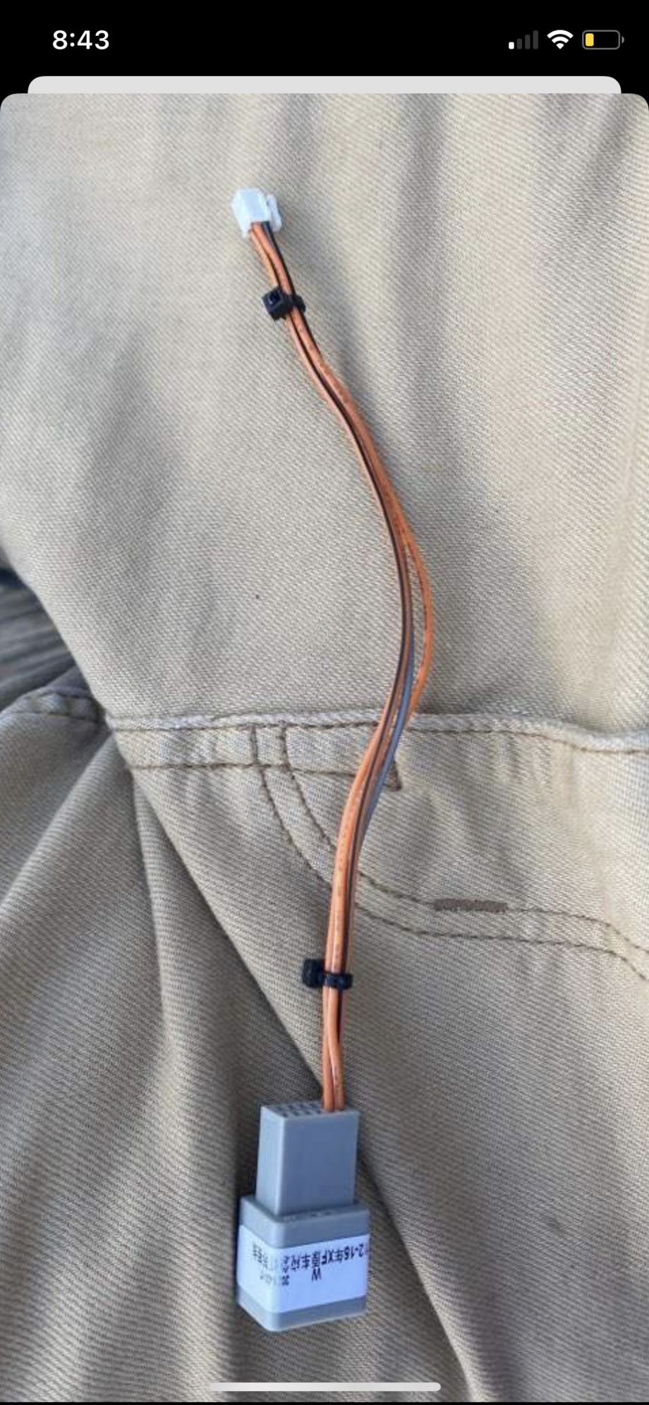

thanks Dennis! Man I see how much we harass you on here and I for one am thankful so thanks man! Yeah they actually sent me the adapter that goes the wire that comes for the car. From that adapter to the radio is what I’m missing…
Old Jul 18, 2021 | 12:17 AM
  #195
jrz813's Avatar
Joined: May 2021
Posts: 14
This is a really crap pick but in the background you can see the adapter connected to the emergency light wire that comes from the car. That orange wire coming from it has the plug your jag uses which is all that’s needed. On your car that white end connects to the radio and the grey side to your car. But with the extra adapter attached I need one with both sides as the white adapter. So any idea what size it is?

is this the piece you need

Kinda.. I have that adapter but on the side, it has a connection for the four prongs i was talking about. From there it goes to the radio. That does look like it would work though but its missing two more wires (that I see you can add on that adapter). What is that female four prongs size?

I had cut one of the wires of this will work for you,for your hazzard and unlock
