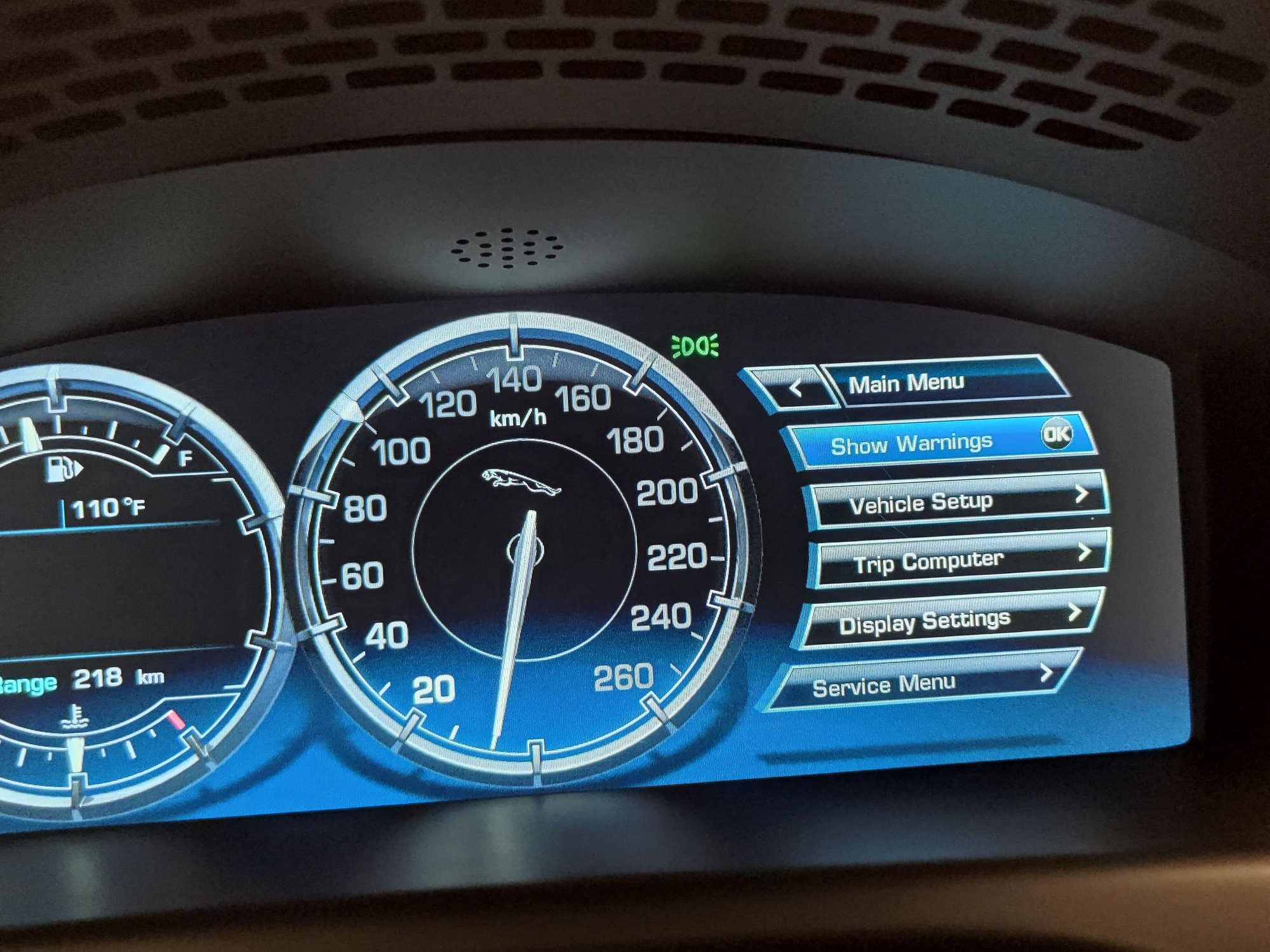

To address the issue of the temperature display: There is a menu where the temperature can be changed from Celsius to Fahrenheit. However, it doesn't do anything when you change it. It displays whatever you have your temperature units set to in your car. It changes back and forth when you change it in your dash menu. No big deal, but previous units allowed me to have a different unit of measure on my head unit than what I had on my dash.

sgtm7 I have pretty much the same issues as you, except syncing works fine (though there's no rear climate on the XK:-). I found that changing vehicles to XF just displays a different climate screen but nothing on that screen functions so it'll be interesting to see what you come up with.
Regarding "To address the issue of the temperature display: There is a menu where the temperature can be changed from Celsius to Fahrenheit. However, it doesn't do anything when you change it. It displays whatever you have your temperature units set to in your car. It changes back and forth when you change it in your dash menu. No big deal, but previous units allowed me to have a different unit of measure on my head unit than what I had on my dash. ", I'm a little confused and it's probably a feature specific to your XJ but how are you able to change it in your dash menu? I don't know what that means. On the XK, the selection is only available on the touch screen unless I'm missing some process. With the new unit, mine behaves the same as you describe. You can select it, but it doesn't do anything. I even went so far as to reconnect the OEM screen and confirm I had Fahrenheit selected (I did). Can you elaborate on what you meant by changing the dash settings?

I guess the XJL has a different setup from the XK. On the XJL, if you press the "OK" button on the right hand side of the stereo wheel, it brings up the menu you see displayed in the picture. That menu allows you to change units, check the oil level, etc. Seems to me, they tried to make a "one fits all" unit, and you are suppose to just change the canbus. However, they overlooked a few things.

Thanks. I suspected you just had better/ other options. There is no OK button on the wheel of the XK and all those functions are in the touchscreen only. Thanks for the quick reply though.

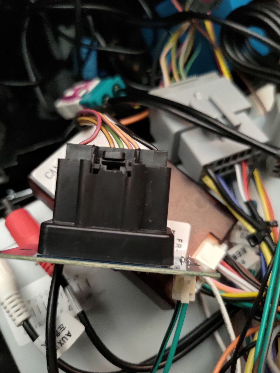

Definitely no valet function. Hazard lights still not working. I can not remove the small board behind of those switches, because it appears that in addition to the 3 screws holding the board, I also need to remove the dial that is attached to it, and I can't find a nut or screw on the dial. I have gained some things, and lost some things with this "upgrade". I will keep it in for now, but not sure if it will become a permanent installation. I have never seen a car without hazard lights, so I think working hazard lights might be a requirement to pass my annual safety inspection. So I might have to swap out the system next year, just to pass my inspection.

The Jaguar has no missing connectors that have the hazard lights. Got a chance to mess around with it this weekend. The connection that has the wire needed to turn the hazard on and off, appeared to be a little lose. I pressed it all the way in, and the hazard lights turned on. And wouldn't turn back off! I disconnected the other plug that was going to the board that had the lose connection, and then plugged it back in, and the hazard lights turned back off. I can disconnect and reconnect that wire to turn them on. Then I can do the same to turn them back off. If I can disconnect and reconnect the connection, I can get it to turn on with the hazard button as well. However, I have to disconnect and reconnect the connection to turn them back off. So it isn't the button, and isn't a missing wire. Can't find anything in the settings that might effect it either.

You have to remove the back panel for the hazzard button, remove the screws then press hard as you put the screws back press the hazzard that it clicks as you are screwing it in, some of these units have bad quality control

My explanation of what I did, probably wasn't clear enough. Although I was hoping it was a simple fix like that, it isn't the button not contacting the switch on the circuit board that is the problem. I unscrewed the circuit board, and pressed the switch on the circuit board directly, while I was troubleshooting.

well the wires are wrong like i show in my video ,ill look at the wiring diagram ,what model and year vehichle so i can look it up

2012 Jaguar XJL. Yeah, since I can make the hazards turn on and off just by disconnecting and reconnecting the jack, I am suspecting something wrong with the wiring at that jack, the wiring going from that jack to the canbus, or the canbus itself. However, unlike with your Lexus, the line for the hazard light is hooked up, otherwise I wouldn't be able to get them to turn on or off just be connecting and reconnecting. Plus, the wiring diagram shows the BN-YE wire going from the switch to the junction box. Assuming that BN-YE is "Brown-Yellow", it is definitely one of the wires from the car harness into the head unit. Problem is, I don't have a wiring diagram or pin out for the head unit, only for my car.
The black connector up front is the harness from the car, going to the connection of the head unit. Disconnecting and reconnecting the small connector with the black and green wire, will turn the hazard lights on. Then doing it again will turn them off. Can also do the same thing at the circuit card end containing the switch. Can also use the switch itself, after doing a connect/reconnect with the harness.

Have you tried bridging those 2 wires from the small connector, from what you describe it seems to be a problem with the switch, try a small piece of wire and touch the solder points with the small connector disconnected.
