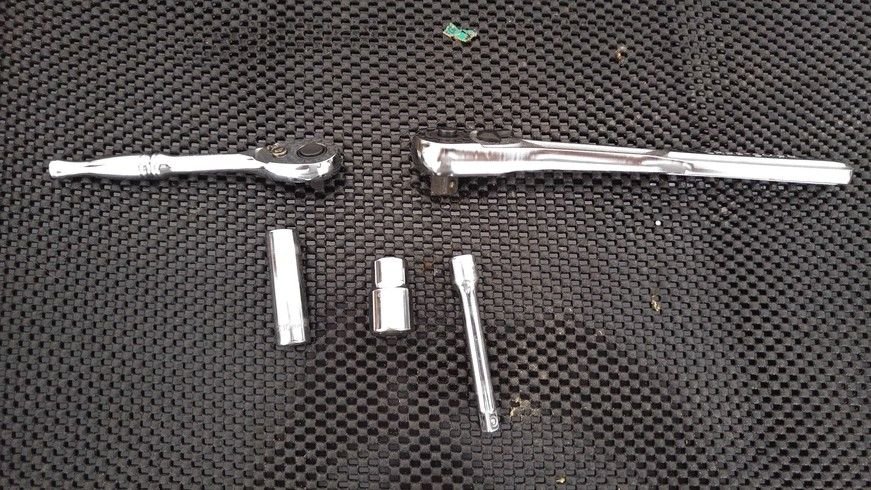

Tools needed: 1/4 and 1/8 inch Socket Wrenches, with a long 10mm socket and an E12 Torx socket. Not Pictured: Beverage of choice.

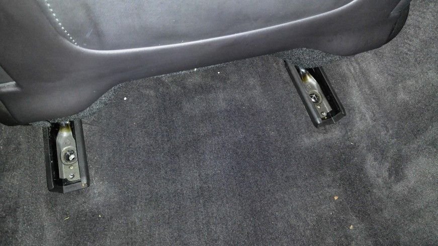

First, move the drivers seat all the way forward, then remove the 2 torx bolts in the back.
Then move the seat all the way back and remove the front 2 bolts.

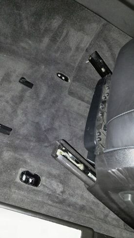

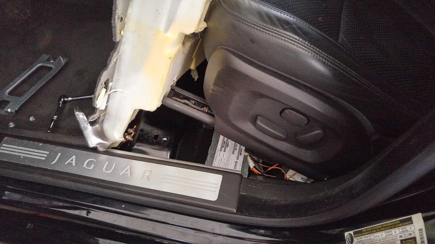

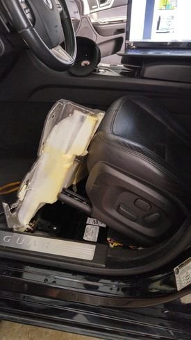

Tilt the seat back, but don't worry about undoing wires or the seat belt, the seat doesn't need totally removed. This is also a great time to vacuum out the black hole between the seat and the center console!
Beneath the seat you'll see where the carpet ends over top the carpet for the rear. Lift up on this carpet to expose whats underneath. You might have to remove the "Jaguar" tread panel to release enough carpet, I did not.

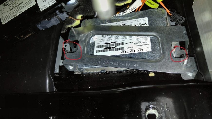

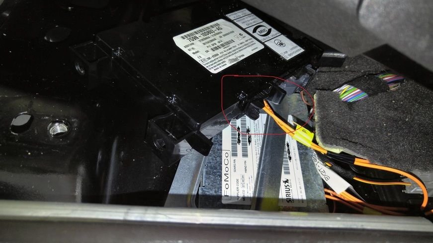

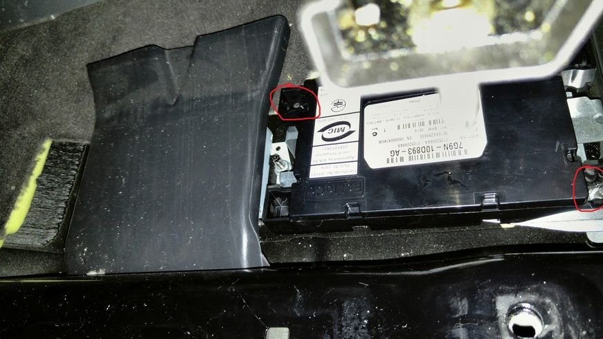

That black box is the phone module, and it held in place by 2 10mm nuts located in the circles in the pic below
Once removed, lift up the module and remove the phone wiring to give you enough slack, the other wire doesn't really need removed.
There is a metal bracket covering the module, you may or may not need to remove it in order to read the number. I went ahead and removed it by removing the 2 10mm nut located in the circles below
Once removed, voila, there's your Sirius module. Here's an image showing where it is in relation to everything else:
Reverse the instructions to put everything back together, and use your radio ID to call Sirius and get some tunes! Hope this helps someone down the road.
