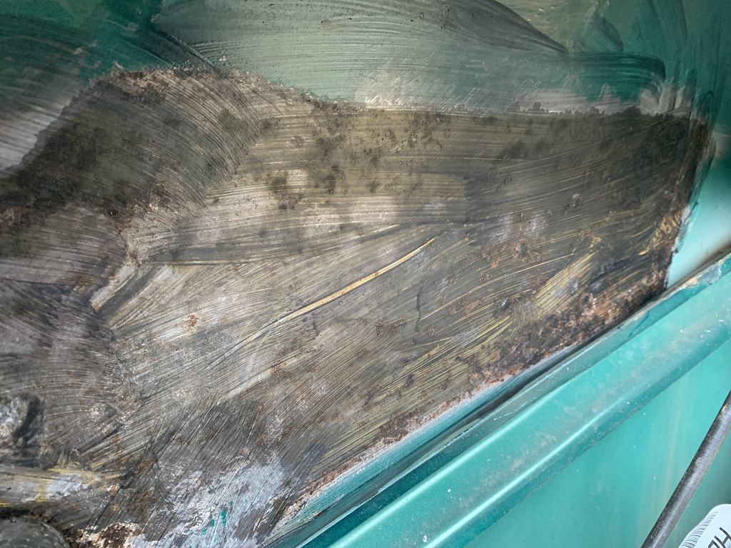

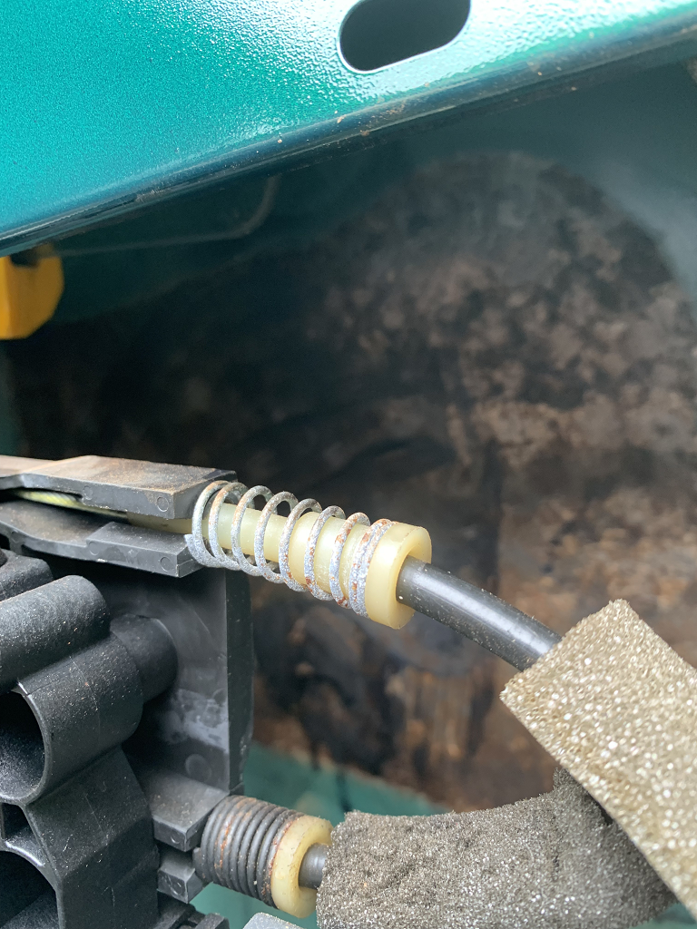

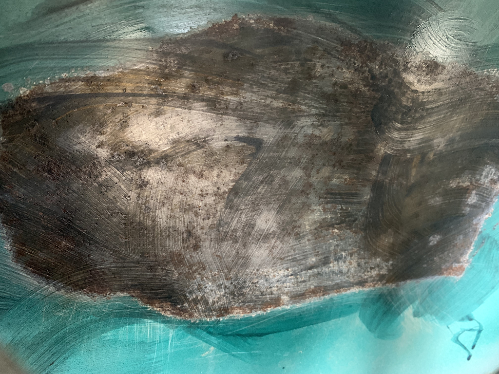

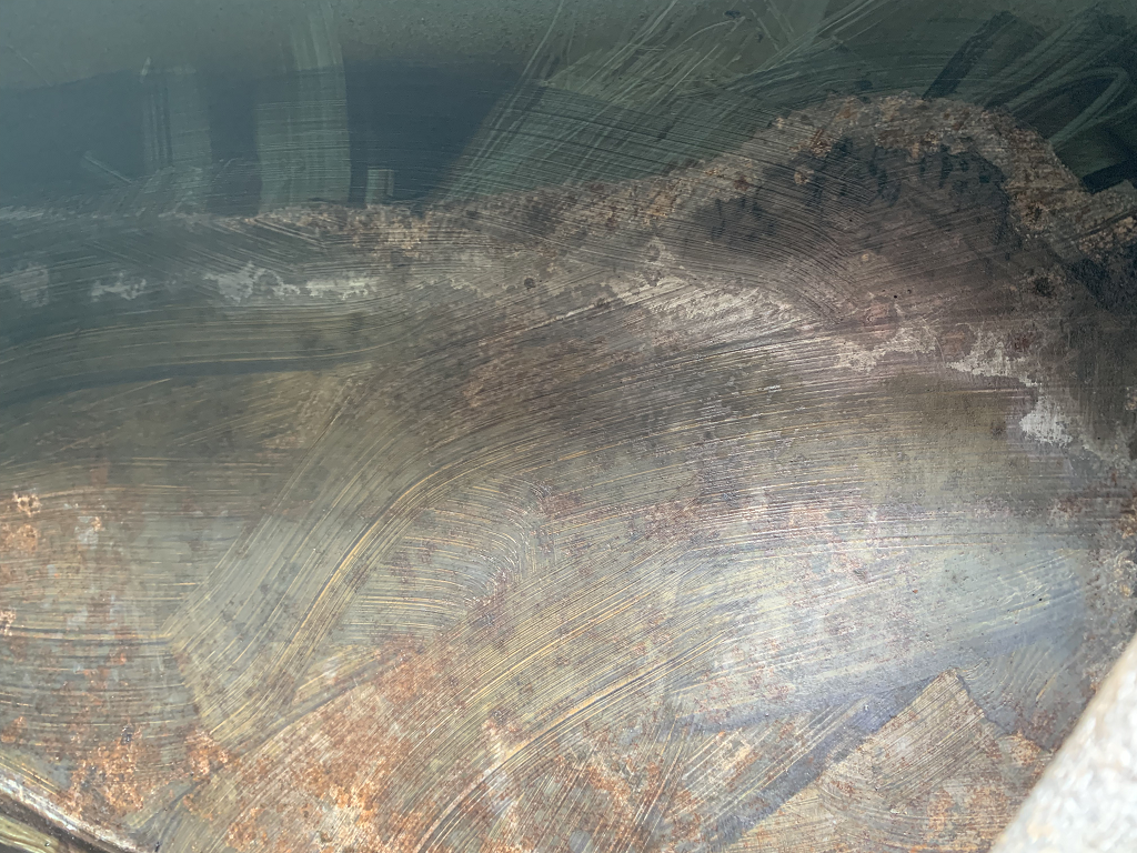

Here are some pics of the door internals, sorry these aren't great, I tried to get the blistering on the outside to show but for some reason the camera refuses to see it. Either way if you look at the door skin inside surface all those dark patches are rust where the galvanising has failed due to prolonged contact with moisture - and no the door drains were / are not blocked. Although the doors were galvanised they never bothered their backside to paint them. The dark patches although it isn't clear are also deeply pitted in spots and this has essentially pinholed the door and blistered the paint on the outside.
In the images shown I have removed the sound damping material, sanded and treated the area with Aquasteel to hopefully inhibit any further deterioration although it is inevitable I guess now unless I tear the paint off the outside also and treat the face of the doors - all in all pretty depressing. I am stuck at a point where I cannot spare the funds to fix this and I won't drive it in this condition such is the OCD about such things.
Right hand Front
Right Rear
Left Front
Left Rear
