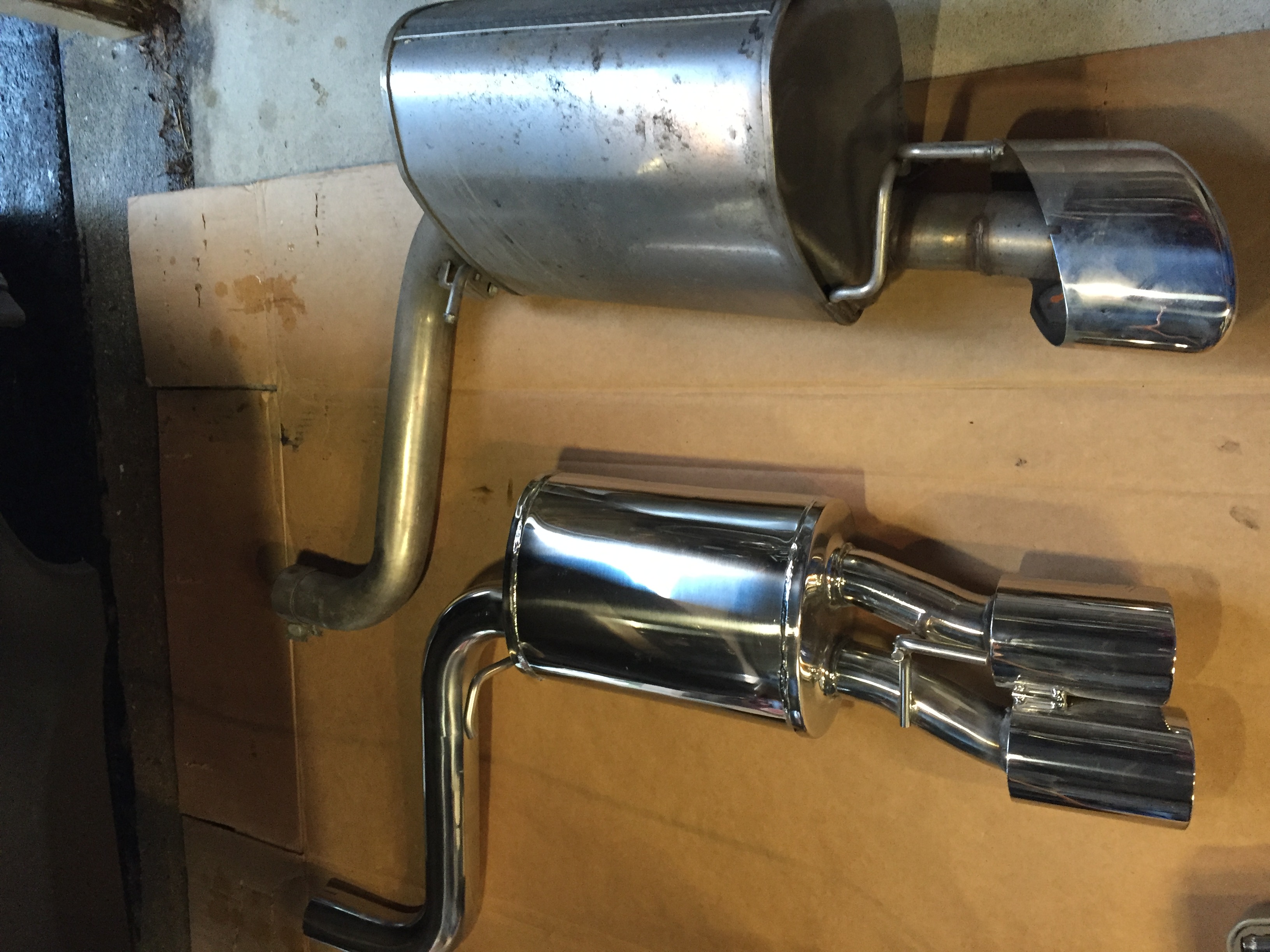

Installed a Mina Gallery exhaust on my wife's 2012 XF Portfolio 5.0L NA this week.
Emailed Mina Gallery to inquire about a forum discount. Was quoted $850 with shipping included. SOLD! Arrived in 2 days!!
The pipes were packed amazingly. Molded thick foam protected each pipe all around. They could have fallen from a plane and not dented.
I opened the entire box flat, laid it down on the driveway behind the car to make a nice work surface. The size of the box was perfect for this! My 14 year-old son helped. I did the passenger side while he watched and let him do most of the drivers side. We had both sides installed in about an hour. Didn't have to jack the car up at all. There's only 2 nuts to loosen; the exhaust pipe clamp nuts, 1 per side. 15mm socket on a 1/2" drive ratchet was more than enough. Could have used a 3/8" drive easily. A little jiggle or two and the muffler pipe slid right off of the mid pipe. There's 2 rubber exhaust hangers per side. Sprayed a little WD-40 to assist in sliding the brackets out of the hangars, detached the one closest to the rear first (black hangar) and then the front one (red hangar). Dropped the unit to the ground and slid it out from under the car.
Slid the new clamp over the muffler pipe and towards the muffler as far as it would go to keep it out of the way. Slid the new unit under the car and lifted it into place. Attached the back bracket into the black hangar first. This helped in holding up the back of the unit and also gave me front to back motion enough to get the muffler pipe in place to slide it over the mid pipe. Pushed it in as far as it would go. The Mina pipe has a few slots milled in the end so you can see how far the mid pipe is into the muffler pipe. Both sides went in fully with no problems. Hung the front bracket into the red hangar and gave everything a nice shake to settle it into place. Slid out from the car and looked at the tips. They were positioned just fine. I've read some comments here about brackets having to be bent, even cut and re-welded, because of bad tip positioning but both sides of mine turned out just fine. Got back under, slid the clamps into place and tightened them fully.
Mina includes new clamps with their kit. I used them, but if I were doing this again, I may have reused the stock clamps. The stock clamps were a bit wider than the clamps Mina supplies and the Mina clamps seemed just a size too large. They worked, but the clamp sides touched and compressed well before the nut was at its tightest. There was a lot of stud protruding. I installed them the same way as the stock - bolt pointing straight down at the ground. Standing behind the car, you could visibly see the studs and it was the lowest point of the car, hanging lower than anything else. I think they would have actually scraped the ground over a speed bump or the driveway. I loosened them and rotated the clamps so they were parallel to the ground. Problem solved, but a smaller clamp I think would have done the trick.

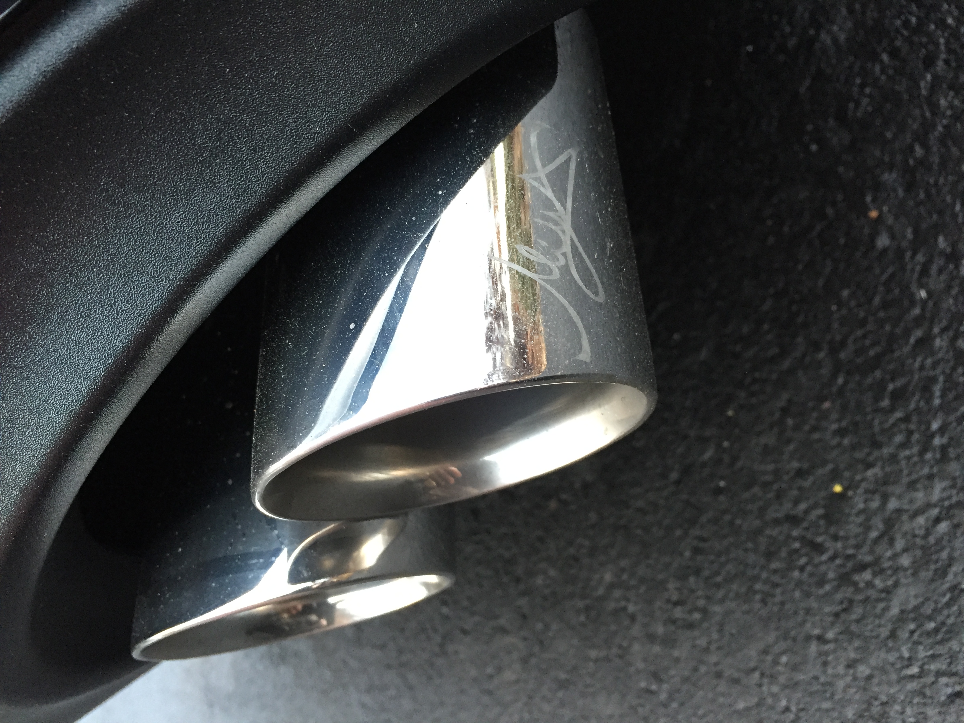

First time starting it up was WOW! Sounds great. Just like everyone here has said, nice low rumble on idle. It is deeper than stock, but not over bearing. We took a family test drive and everyone was more than happy with the sound, especially the wife. She was looking for something that wasn't too obnoxious and this exhaust kit from Mina fits the bill perfectly.
On the test drive, heard a thumping sound from the drivers side on acceleration and bumps. Not too bad, but noticeable. Got home, grabbed the tips and gave them a good shaking. There's a metal bracket, just behind the end of tip that is part of the body of the car. This was hitting the pipe when it flexed. I've read about this on here so I was sure before I looked that this was what it was going to be. Shook the passenger side good and no problems there, everything is clear. A simple punch and hammer to bend the bracket back gave enough clearance, but was a pain with the pipe and tips there. Would have been much easier to bend this (or grind the corner off completely) during the install when everything was out.
