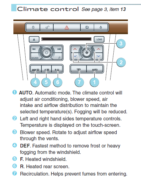

Not normal.
Automatic AC works all the time unless you select OFF or AC OFF on the touch screen, or deselect Auto on the dash switch.

When you first get in and start the car in hot weather the A/C system should go into recirculate to provide maximum cooling.
Then as the temperature starts to come down the car should switch from recirculate to regular A/C which would start to bring in additional fresh hot air from the outside.
Do you know where the recirculate indicator is so you can see if it's coming on?
It's in your owners manual.
