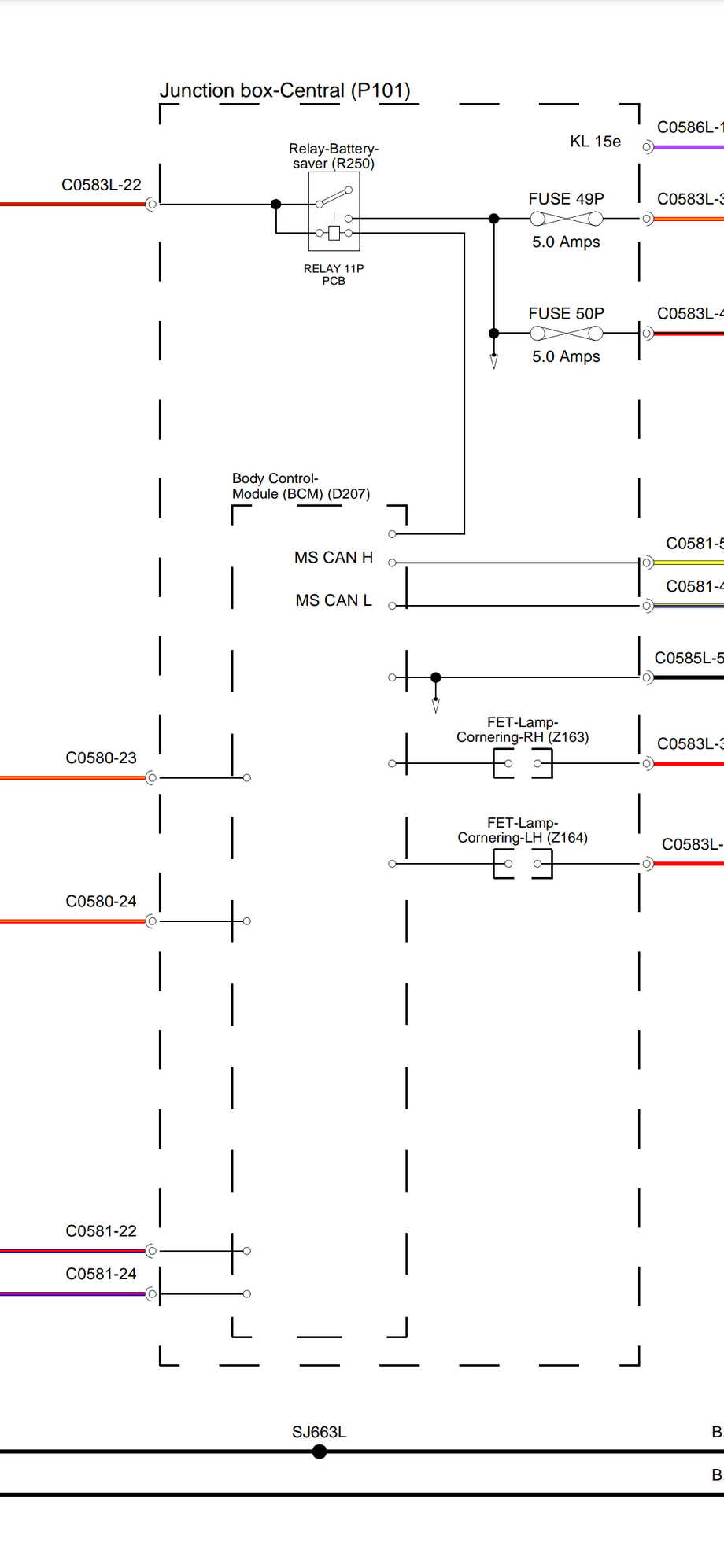

Originally Posted by Kaapo93
Thanks for reply, I changed the battery year ago but it didnt help. I'm going to check the bulbs then, it just feels odd that both of them would be broken yet still working but then again, I'm not a mechanic let alone electrician
If the bulbs work there is nothing wrong with them. The bulbs are fed by separate FETs so it won't be that either. Maybe the ECU.

Old Sep 8, 2021 | 11:15 AM
kansanbrit's Avatar
Joined: Dec 2013
Posts: 978
Likes: 275
From: Kansas
Its all part of the main fusebox. Might be worth checking bulbs are correct wattage.
Schematic is for Range Rover Sport. Sorry, I work on both, was getting a little confused.
