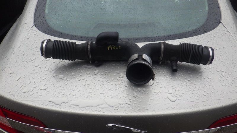

Air leak? Could this be related to the center air intake tube under my hood that is split open? I am using tape to hold it together right now, hoping air won't escape or go in.

Ouch! Yes. Fix it urgently.

Additional unmetered air is coming in after the MAF sensors and not being monitored, odds on to be the cause of your rough idle.
The car will run with the MAF sensors unplugged or removed (been there done that) but it will idle very rough.

any place I can buy the air intake tube for a good price?
What year, what sub-model, what engine?
I'm guessing 5.0 V8 NA but who knows!

Air box for Jaguar

Air box for Jaguar
hm...That doesn't look like it will fit my car though but I'll look. Thanks all.
Are the parts here reliable?
