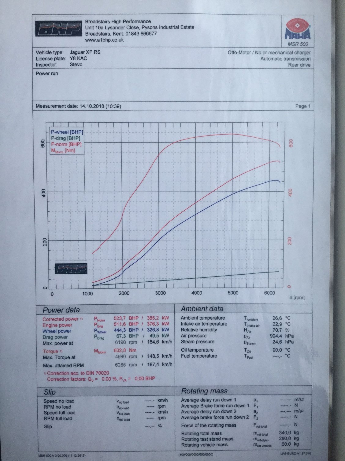

Results attached Run in 4th
Standard car still under warranty.

My car is still under warranty as well (at least in my mind it is)... and I can see why the results are a little underwhelming... mainly on the torque front, I think the HP is within the general vicinity of close to stock 524 vs 542... It looks like the dyno operator took his time rolling into full throttle, and this may have had an impact on torque. You don't develop peak torque to 4980rpm. 632.8 Nm is the same as~467 lb-ft. Stock the torque is claimed to be 502 lb-ft @ 2500rpm
