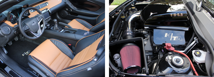

I just got off the phone with a friend of my brothers who owns a Hurst Trans AM with a metal intake and he said, although the tube gets hot at times, He has never noticed a decrease in HP. So if that's the case, The temp of the metal tubing is less important as to the amount of air that you can flow through the intake.
