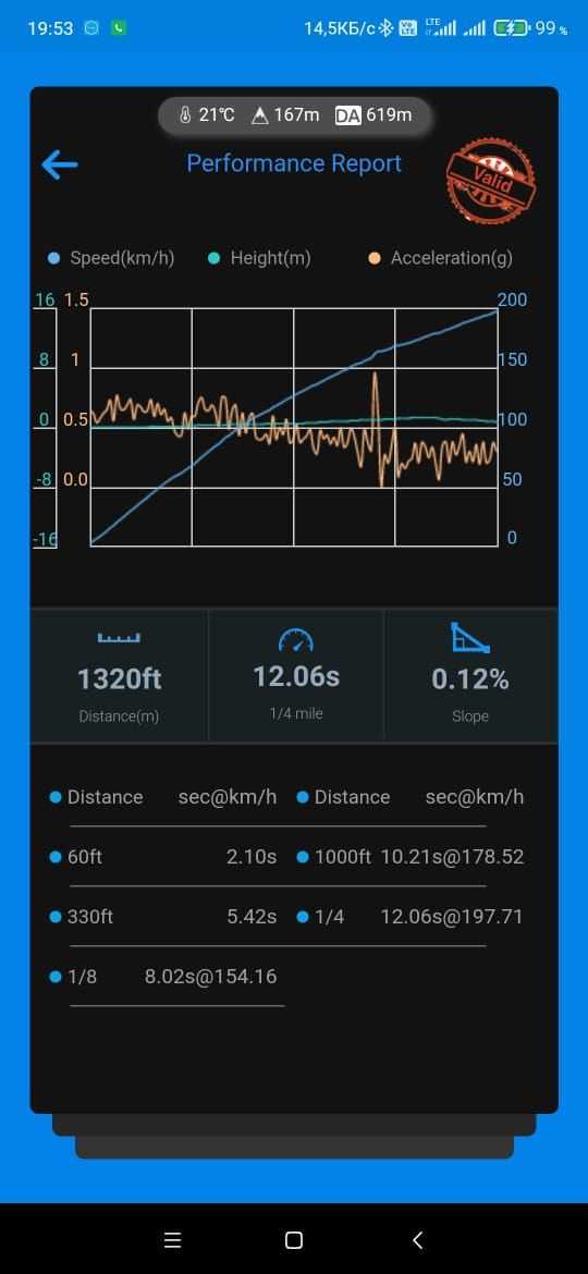

Didn't had a time yet to do a dyno, but im trapping 1/4mile at 197.71kph (121.3mph) on a public road (on a track i think ill be faster) on mine long Supersport (Denso ECM and 6hp28), with a full tank, 125kg driver and lots of junk in a trunk

Well, F-type is a bit diffrent car. AWD, plus diffrent rear diff ratio (2.56 XJ vs 3.31 F-type), so they putting more power to the wheels.
This particular run was made on a Triangle TH201 tyres, if ill put semi-slicks on, new air filters and a skinny driver (lol) it - it would be 11sec. Not to mention that the traction on a drag strip is way better than on the public road, where im testing
I've seen, but not intrested tbh (im runnin 6hp28 and slowly developing mine own tune for it). But i'd be very cautios with a trans tunes, i do know cases when a tune killed a transmission (and it's as easy as 1-2-3).
