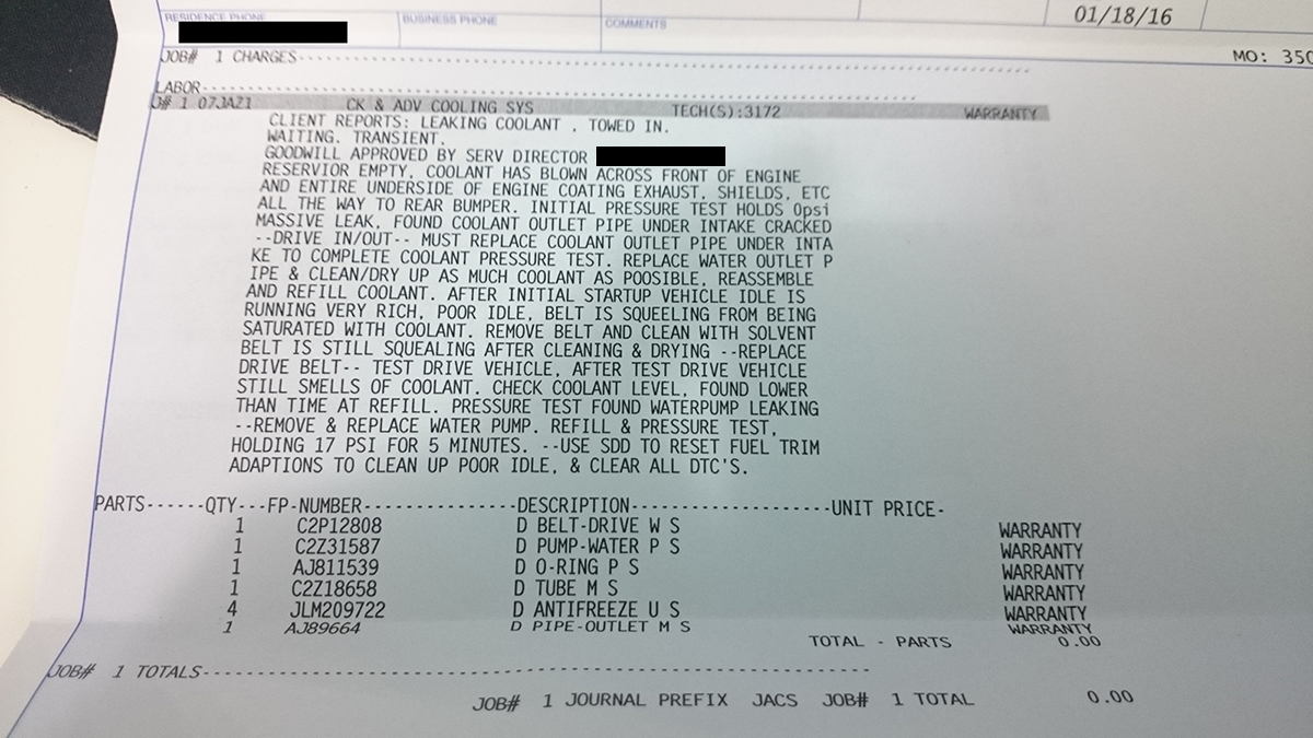

I was driving it from Palm Beach, FL and around Georgia the low coolant notification was on. I clear the warning and drive a little further until we can pull off and top the coolant off.
Once the car is cooled down enough I fill it back up. 30 minutes down the road the Coolant Warning comes back on again, so I I pulled off as we were right near an exit, parked it and the engine was smoking due to the coolant being sprayed all over it.
The next morning they towed the car to Hilton Head, SC to Hilton Head Jaguar where I received the most amazing care. They changed the water pump and a coolant pipe and I was told that this had to have been an ongoing issue as under the car was caked with coolant. They cleaned it off, checked the engine, and I was back on my way. This was done as a goodwill repair because my CPO wasn't "showing" yet. I did specifically ask for them to take a look at the head gasket because going into the dealership that seemed to me to be the most likely cause of all my issues, having just done a head gasket on an older car of mine. They did report that everything seemed fine.
