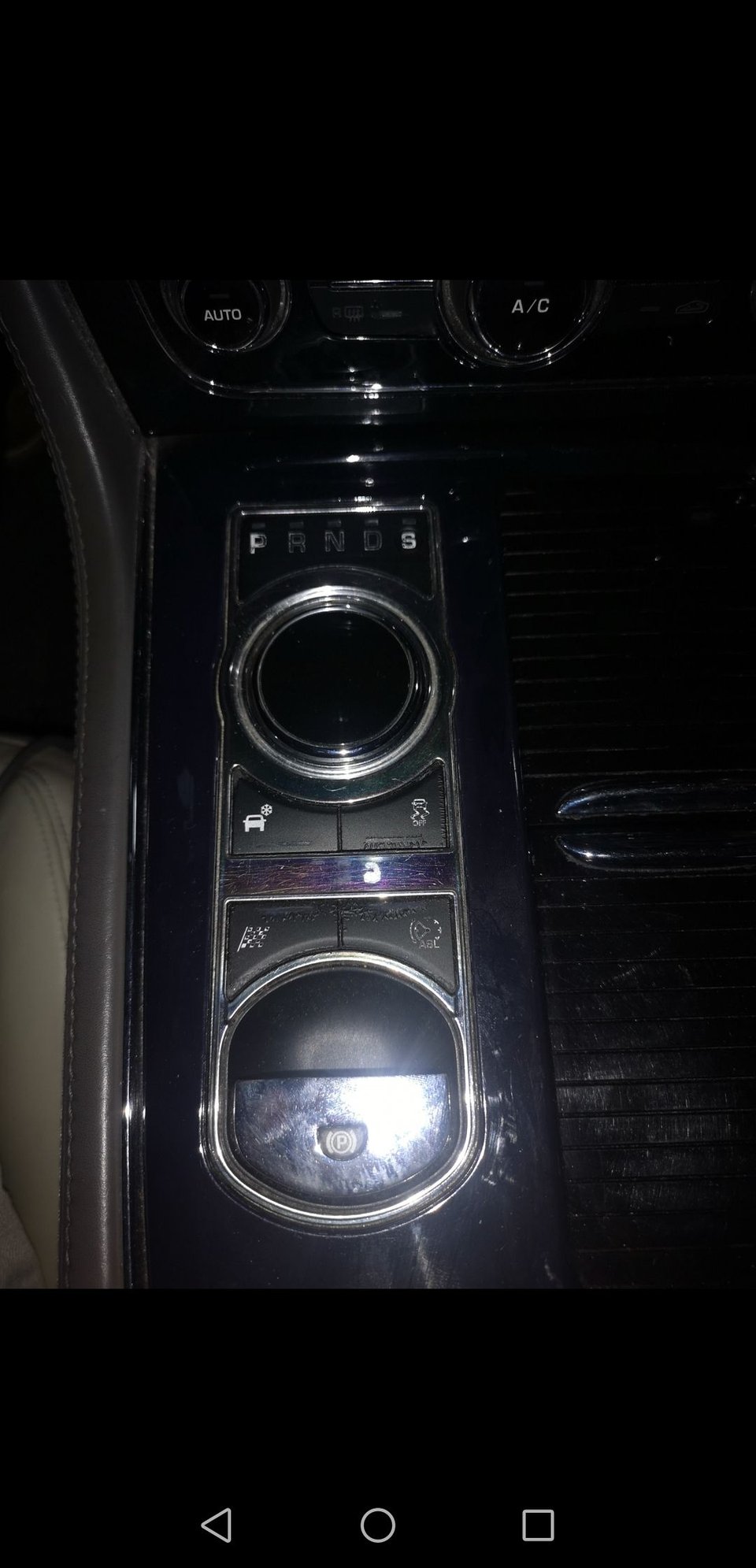

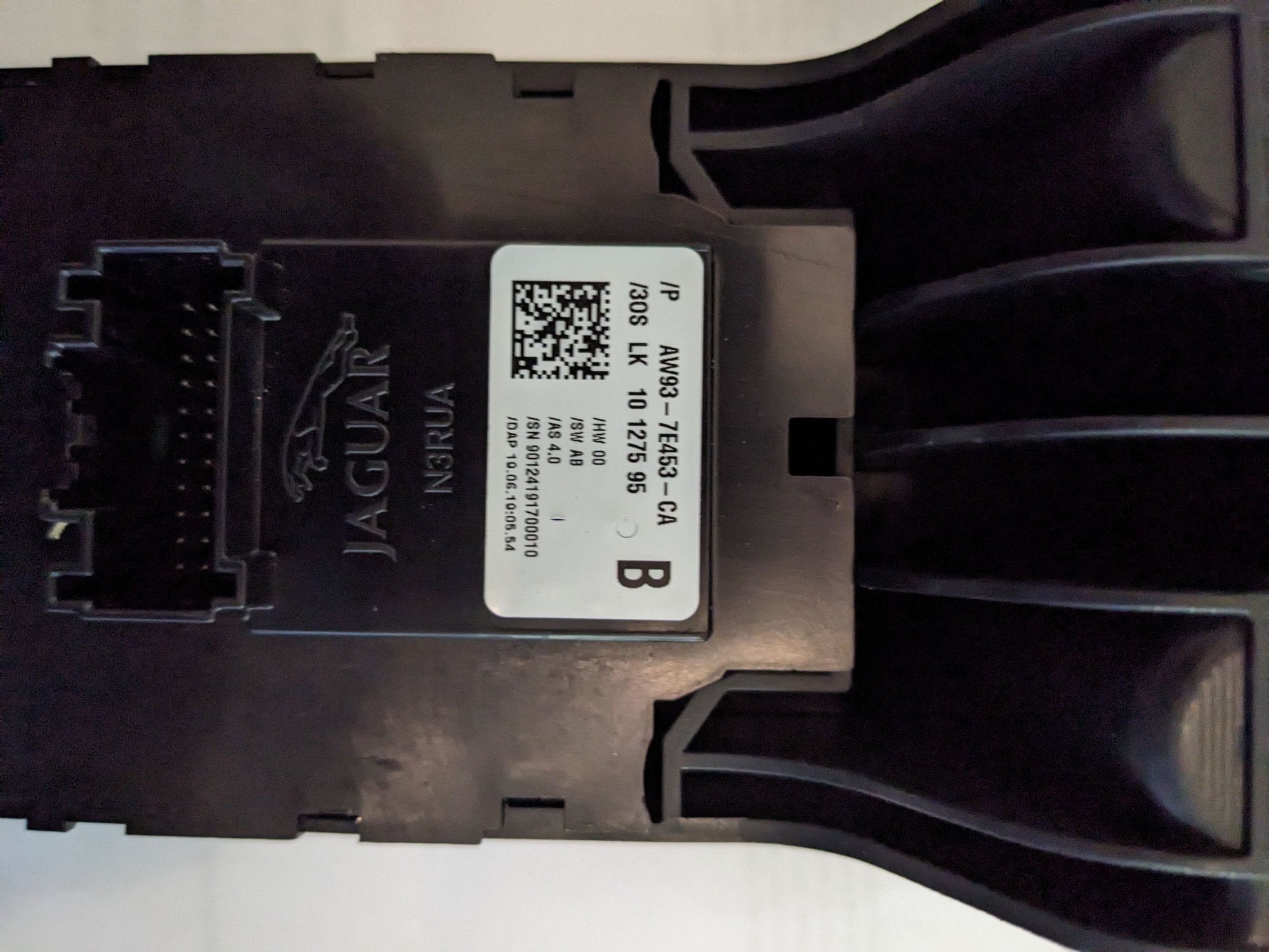

In my 2011 XJL the buttons had been "cleaned" but the quality of the cleaning was poor, with some of the labeling rubbed off and the sticky bits still in the unseen areas of the buttons.
I discovered that when I did the work to blacken a lot of the decorative chrome in the console that was blinding me on sunny days.
So I sourced a good one from a 2019. It was about $100 on ebay. I did confirm with my dealer that all model years were compatible.
Fortunately I have yet to use it so pics were easy. Pics below have the numbers you are looking for. The X150 reference is interesting in the 2nd pic.

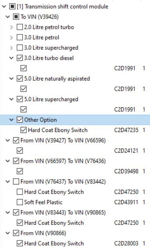

Looks like that part had many different part numbers over the years. Way more than I would have thought.
Most are superseded by C2D43911 but I see the early part number C2D1991 too.
You can use the last 6 digits of your VIN to narrow it down. Glad to hear the dealer says all 2010-2019 are the same so maybe all these numbers have been simplified.
