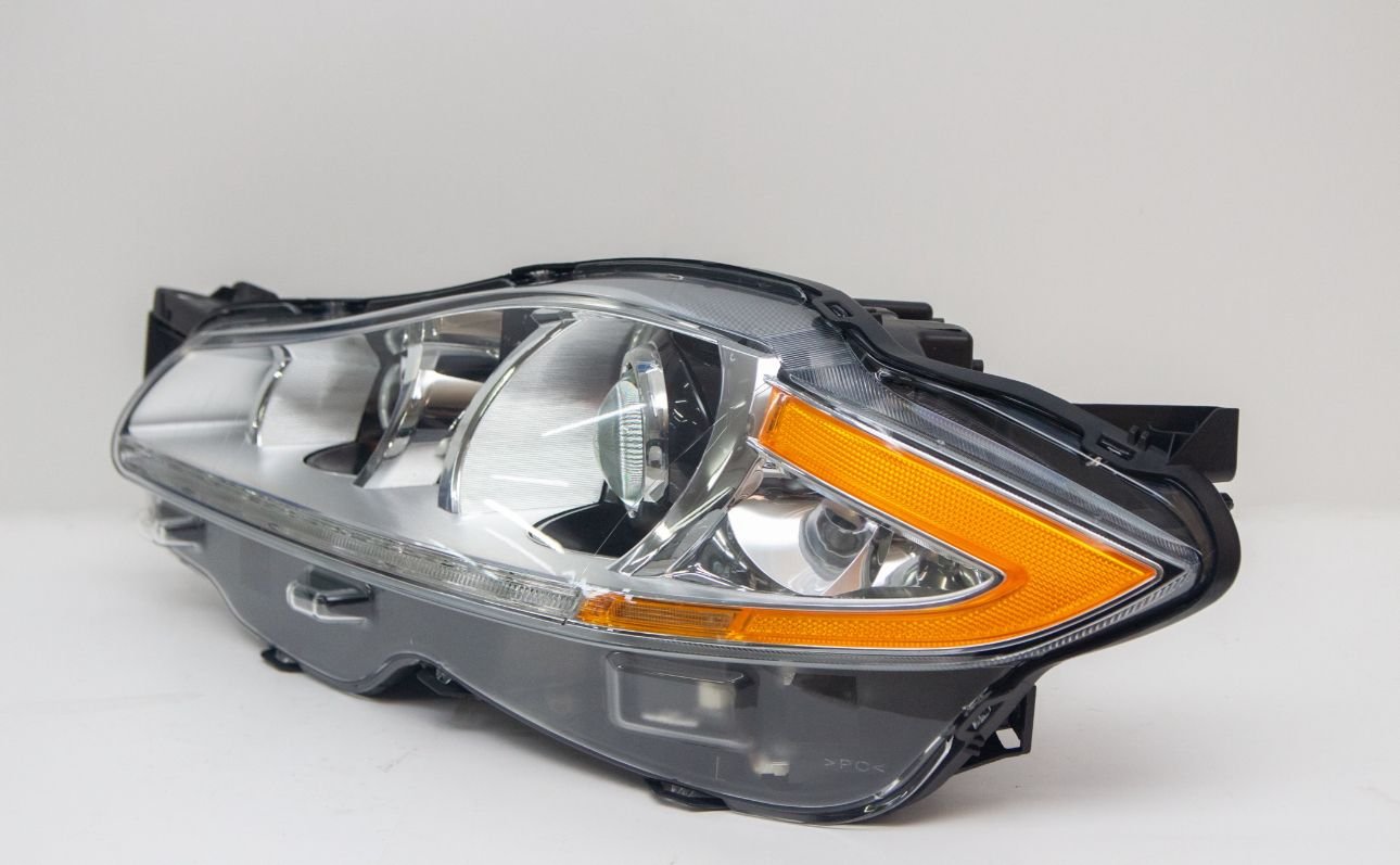

If your lights move left and right then quickly back to centre when you start the car with the lights on then you have AFS. From memory the AFS won't operate when the vehicle is stationary - you need to be moving to see the lamps move after the initial calibration.
You can also tell by looking at the headlamp assembly itself. If the outer corner section has a lens in it instead of a silver insert with the jaguar leaper then you have AFS. If you see a jaguar leaper instead then you don't.

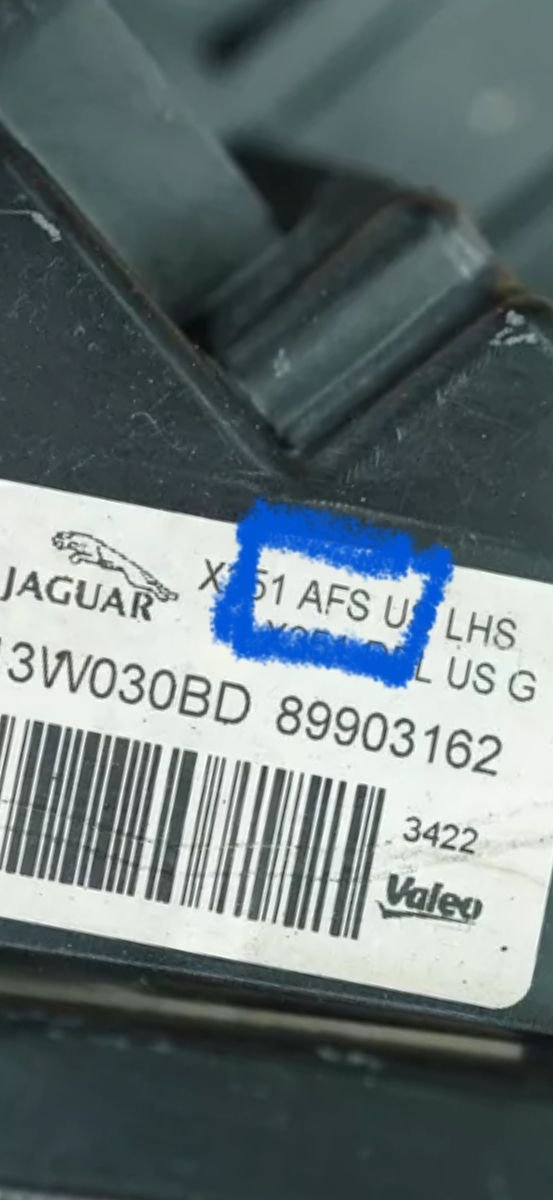

how can you tell if this is a afs model or without afs ?

There will be a sticker on the housing. Look for AFS. You’ll also see a yellow headlight with arrows under it on your dash at night if you have Adaptive Lights.
