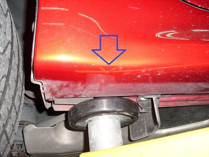

This is old info but just in case I will post it again.
There are arrows cast into the plastic body work so you can position the jack in the right spot.
But they are very faint and at first I did not believe they were there until I got under the car!
