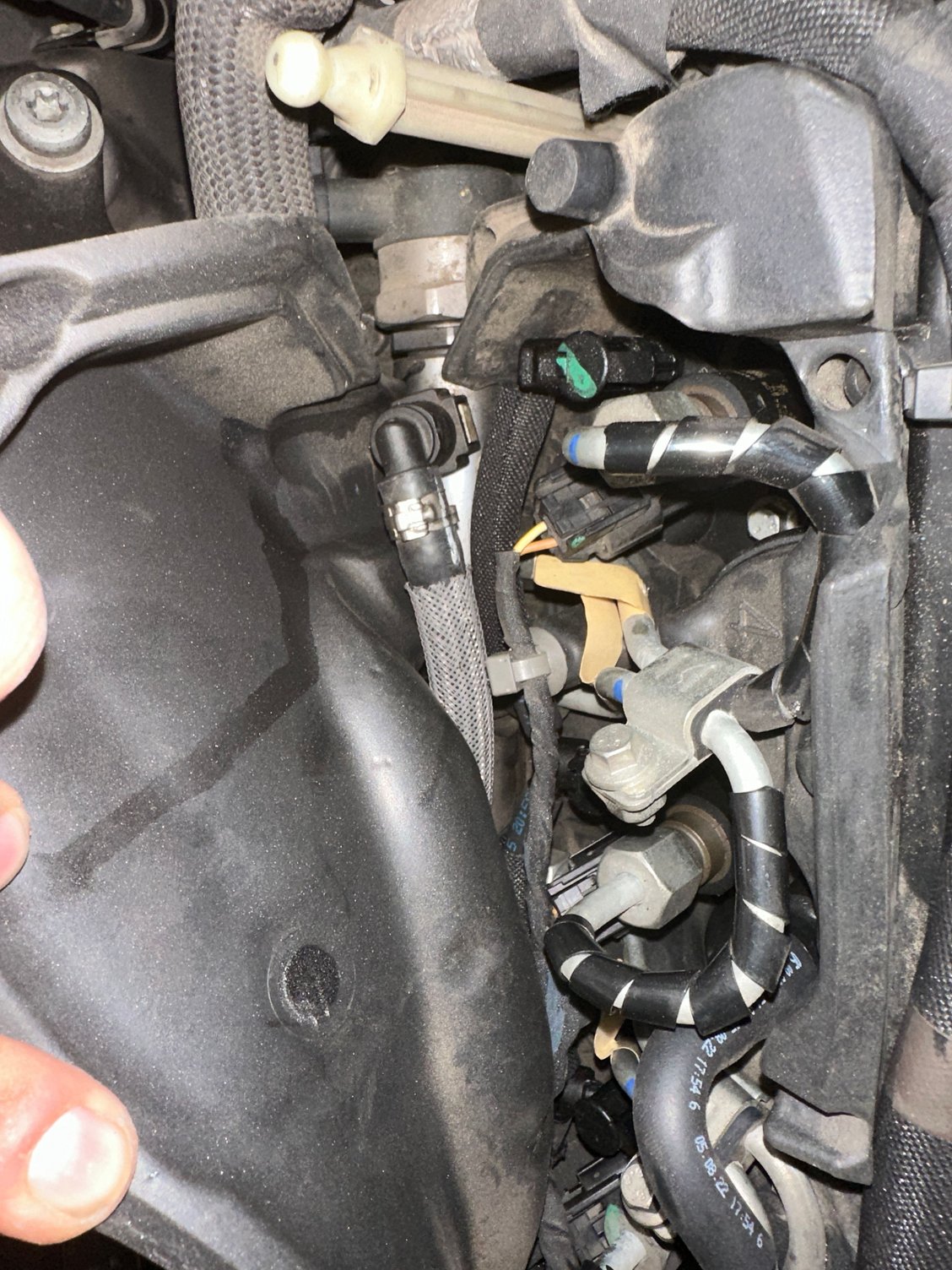

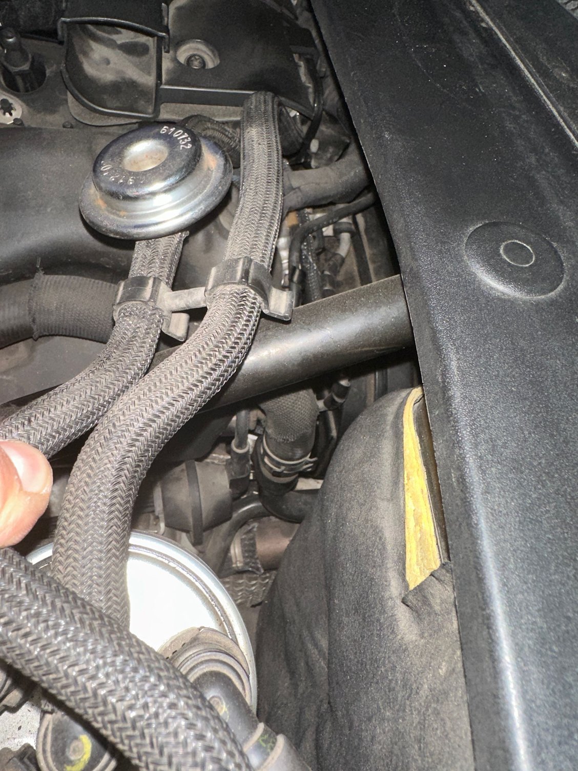

So…. I took a look under the engine cover at thplastic cover of the rockers. Seems to be ok. Egr….. Seems to be ok. But…. In the driver side corner of the engine, on the lowersider, where I guess its the turbo, you can see in the pict that is something oily over there. In the corner…. Towards the firewall.
Egr area
Rocker cover area…. Injectors….. Seems ok. Please have opinions
And….. Down under.… over there in the corner...
Just under the reddish copper looking pipe….. Some oily area. Its the turbo zne?
Ideas?
Just got the turbos refurbed In a specialized big shop here…… and I heard that are numerous examples of failed turbo in 1-2 monts since refurb at the same firm. The refurb was 850 euros. Only the refurb.Can you tell me….. Turbos can get off the car without engine of the car? Again?
So…. Please…. Opinions and ideas are wellcomed

From my eye spot the injectors are bit wet? (bypass pipes?)

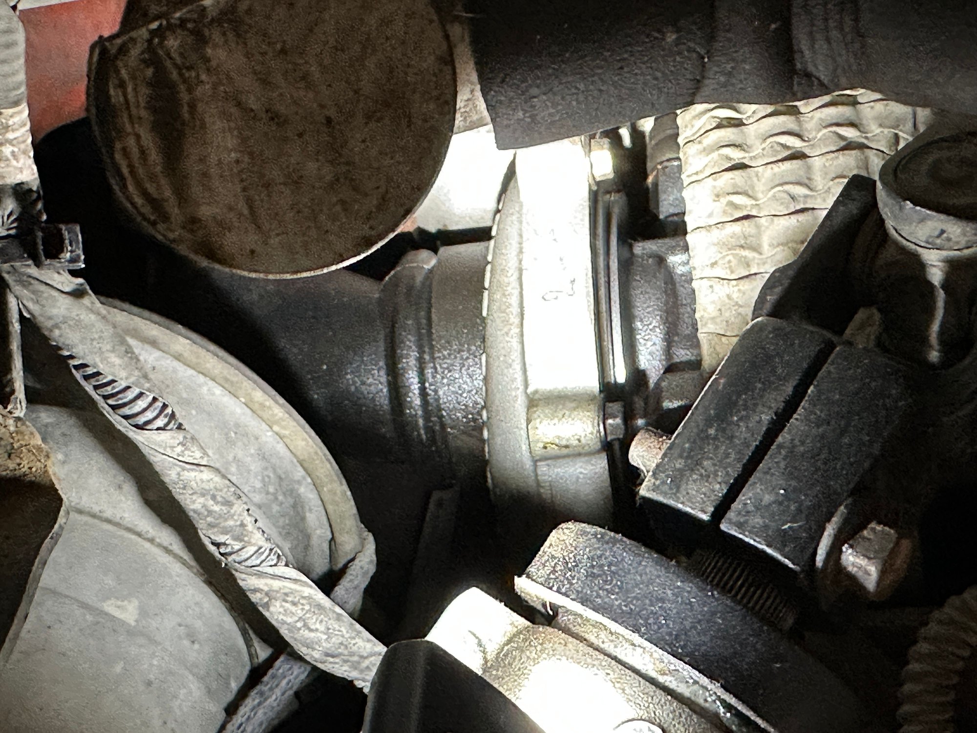

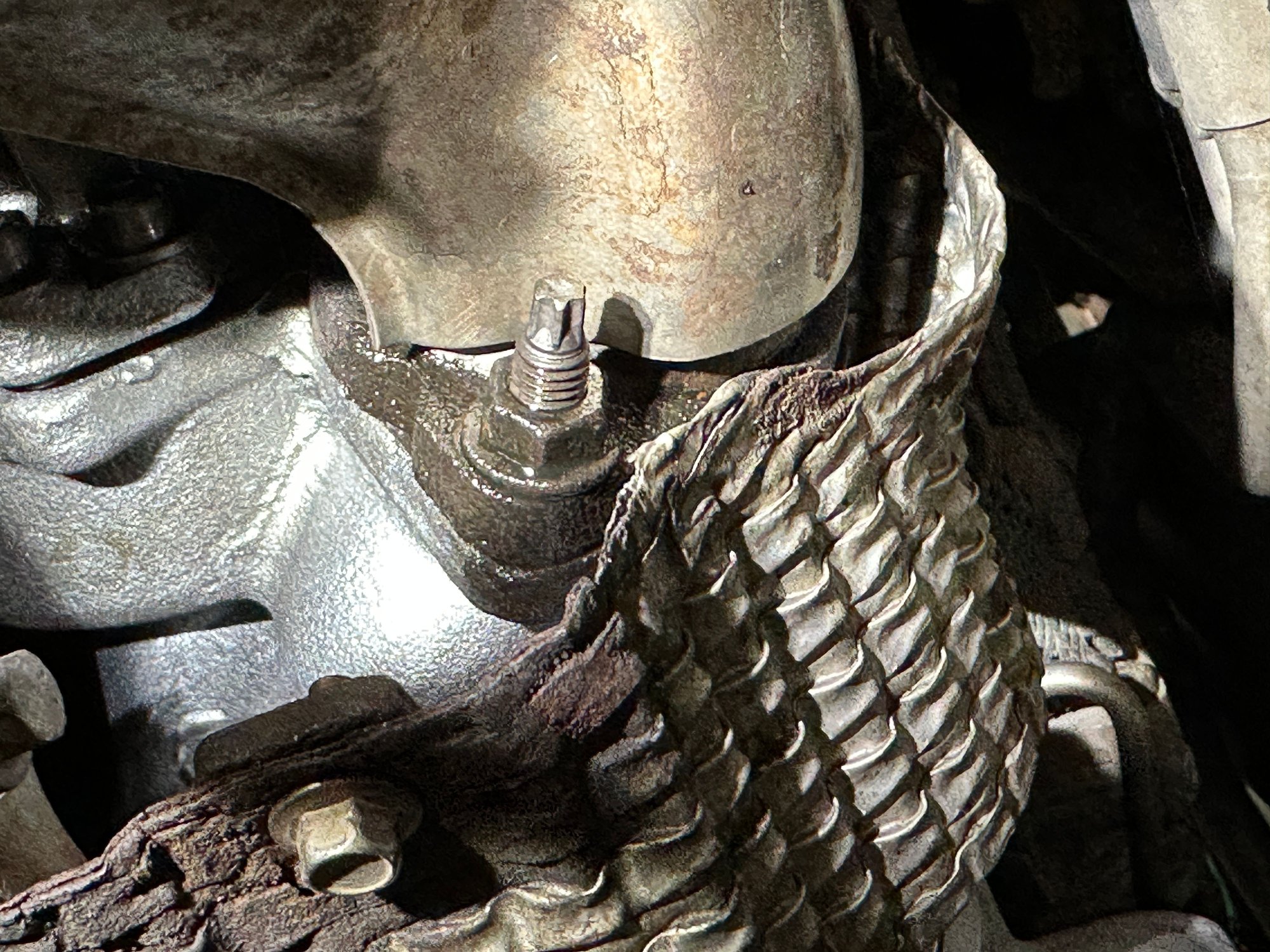

So….. Follow up on the smoke and smell
Left hand drive car
Driver turbo smoking a bit from the plastic tube connection from the head of the turbo
The back is ok.
Passenger side turbo oily on the dpf gasket. And some oil on the same side in the v section that comes from the intercooler do the turbo. Verry slim oil traces on the other side ov the splitter from the intercooler.
All this after couple of hundred km.
Just got them refurbed in a big specialized shop for 800 euro.
Now….. Guess the refurb is under warranty….. And.…… engine down for taking out the turbo. Labor? Oil? Coolant? And so on.

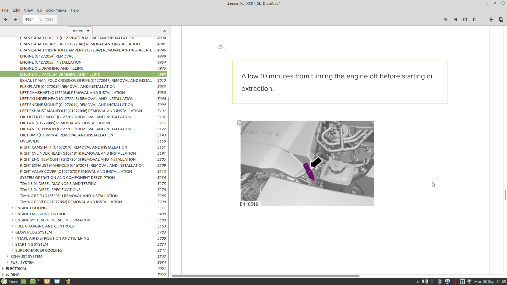

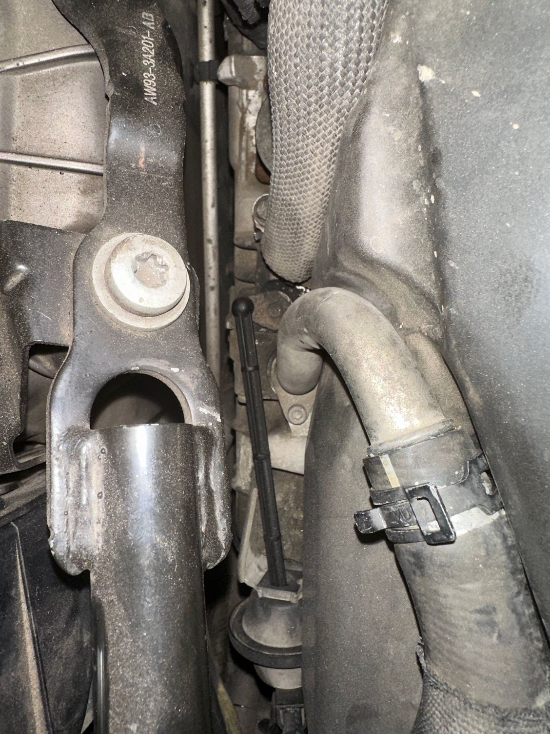

There is a pipe you can connect to at the top right hand side of engine (covered with small black cap) where a dipstick would be sensibly situated!
Can suck directly from the pipe (if you can get a good seal). It may be possible to pass a thin pipe down it but never tried.
