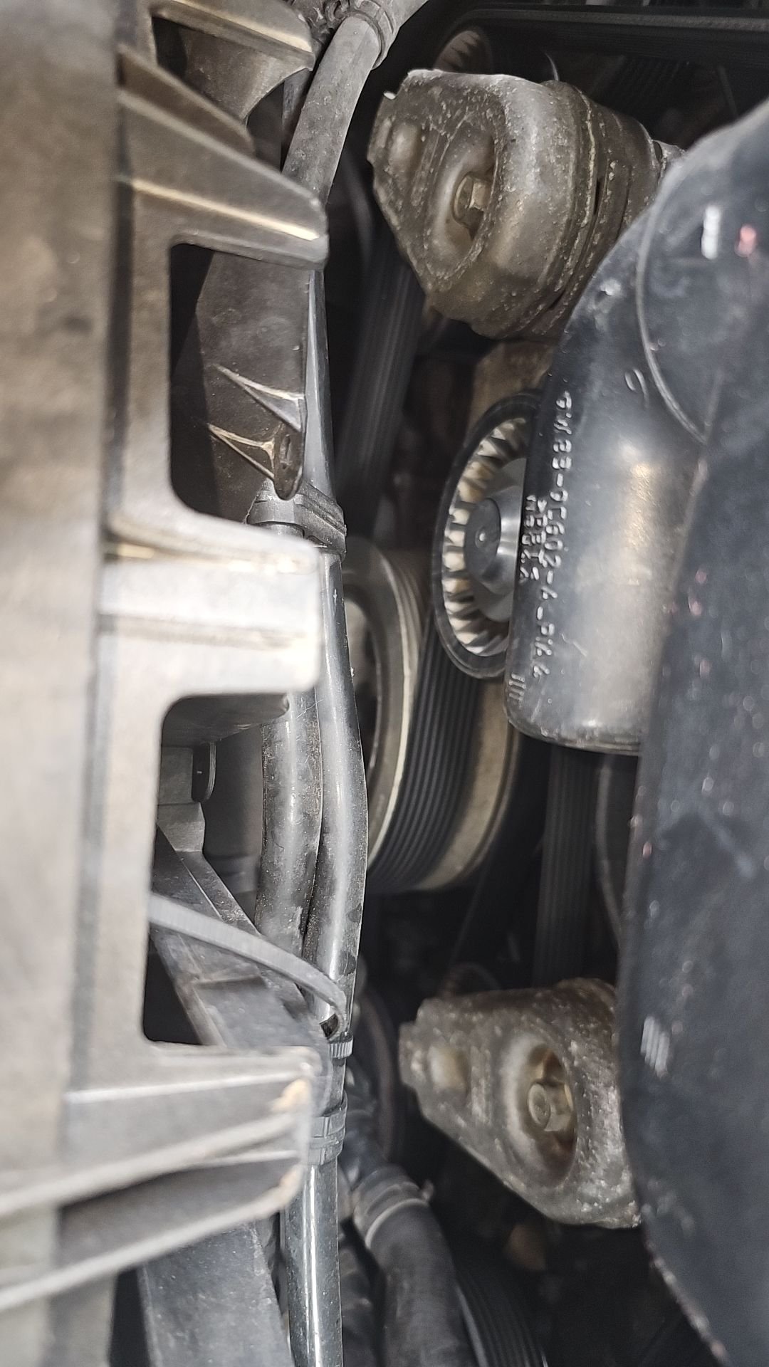

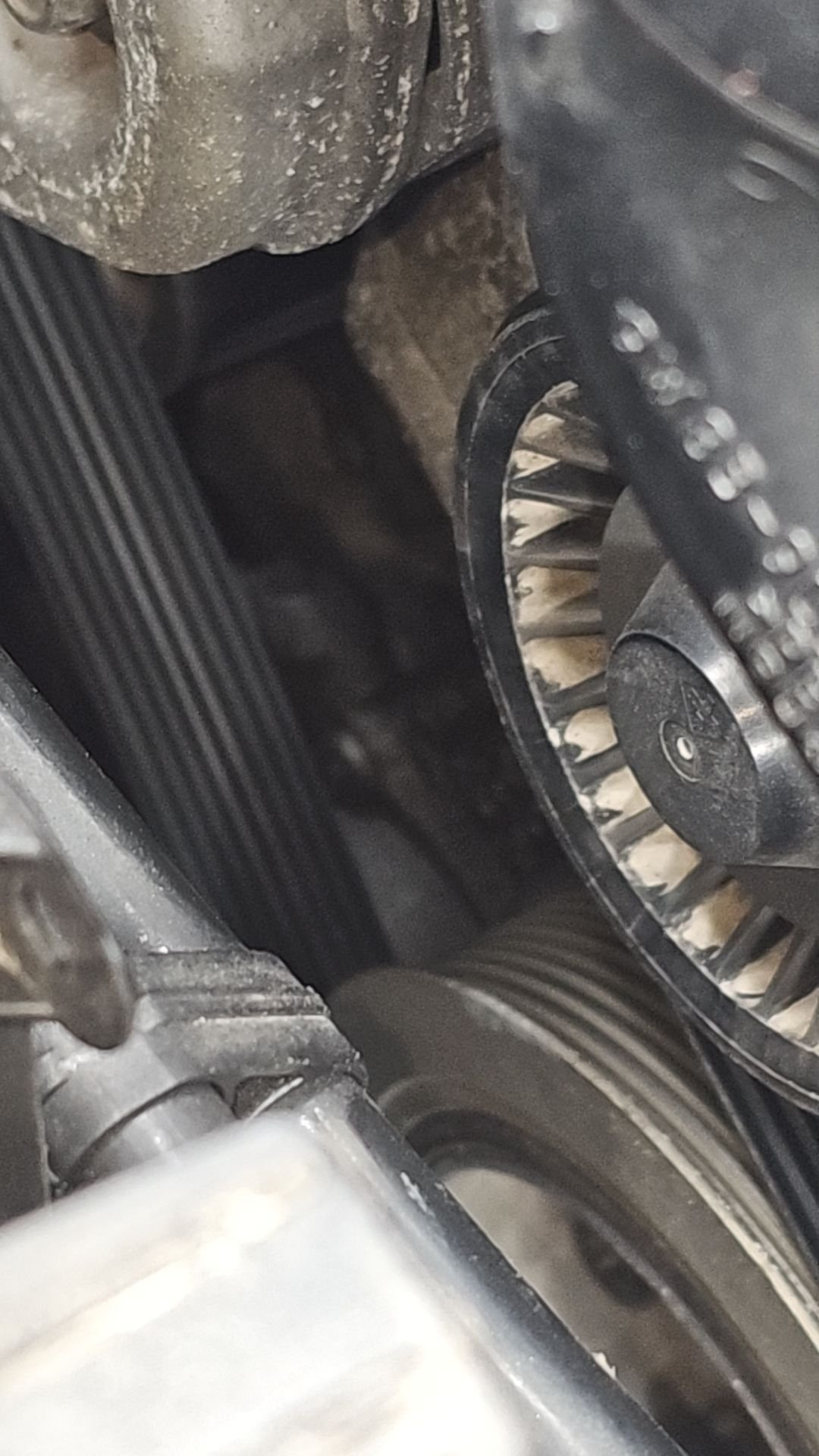

So I have a slow leak. I believe it is coolant it's super hard to tell where it's coming from without taking everything apart. I see it pooling up right under the bottom pulley anybody know what is leaking?
it's kind of hard to see in the pictures. But it is all wet behind that bottom pulley please help. It's a slow slow leak though.

The simplest way to find a coolant leak is to pressurise the system to 1 bar with a cooling system pressure tester when the engine is cold. If the pressure shown on the gauge begins to drop, look around the engine compartment for leaks using a mirror.
The location you're indicating as damp under the crankshaft pulley is often caused by an oil leak from the vacuum pump.

Okay I'm pretty sure I'm not leaking oil I guess I'll have to pull the skid plate off to see I just did an oil change. Evac. I pulled out the right amount. Pretty sure like 7 quarts or something. I know I have a coolant leak I can smell it

It could be the water (coolant) pump as that is a well known failure point on the AJ133 and AJ126.
The water pump is the highest mounted pulley of those driven by the accessories belt, it sits immediately below the throttle body and immediately above the crank (bottom) pulley, therefore any coolant pooling behind the crank pulley could well be coming from the coolant pump above.

Thank you so much I'm thinking that's probably what it is. If it is the water pump leaking can gaskets be replaced or does it need a new one. How hard is the diy. Maybe I'll go rent one if those pressure testers at the autozone by my house n try to make sure that's where it's coming from.

Never had it done myself but I understand that the whole water pump needs to be replaced not just gaskets, seals and o-rings. Also JLR cannot get the design right and so far there have been at least four different versions. Not sure how hard it is to DIY and also can't remember if the SC needs to come off or not but either way I suspect it is not a job for a rank amateur.

If they haven't been replaced already, the water outlet pipes under the supercharger snout, and the heater pipe between the cylinder heads at the back of the engine should also be replaced as they are also known failure points in addition the faulty water pumps.
As a point of caution: should you ever see a 'Low Coolant' level on the instrument cluster, stop the engine immediately to avoid catastrophic engine damage from overheating. The AJ133/126 head(s) and or block can warp from overheating causing the head gasket(s) to fail.
