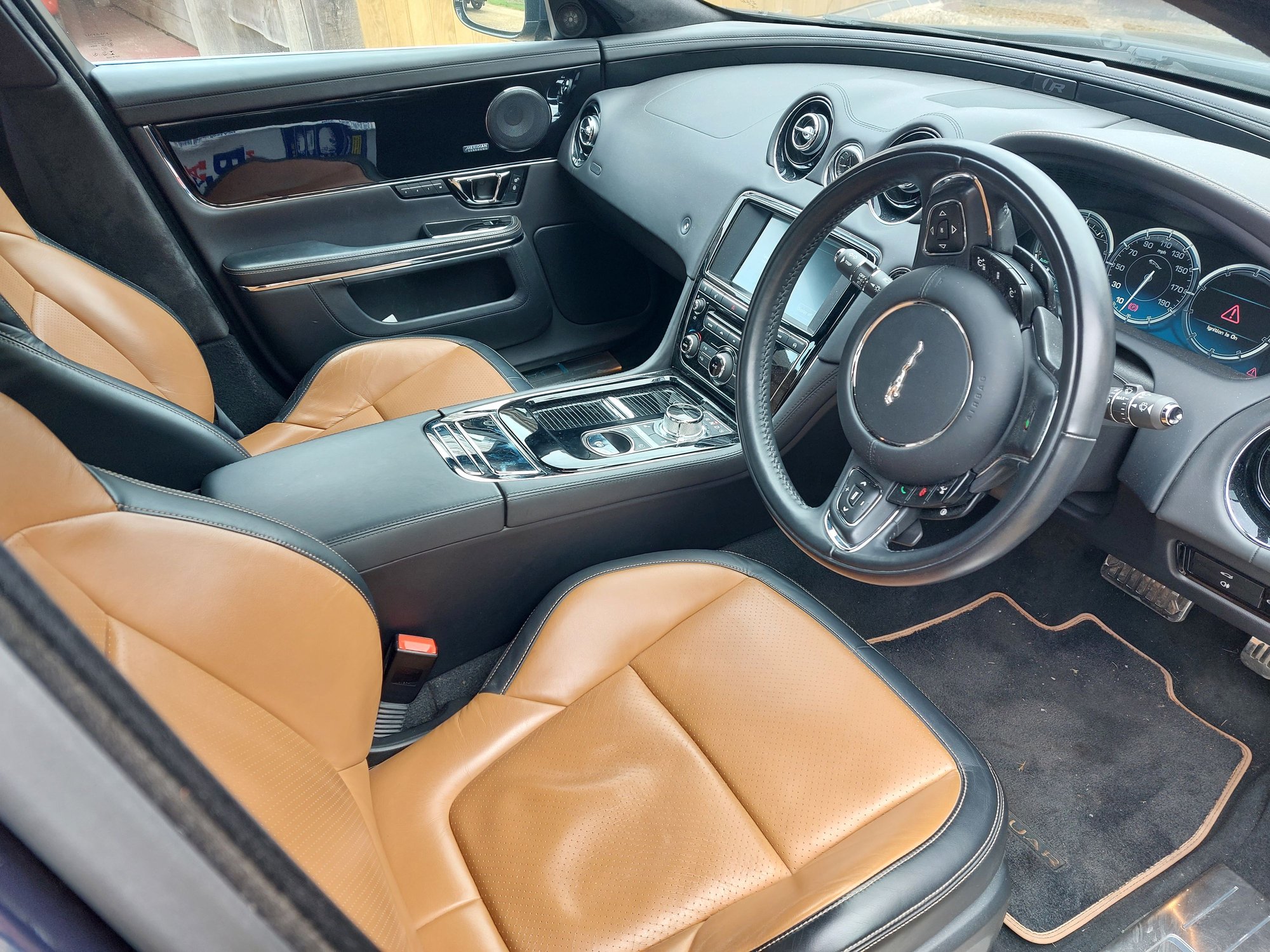

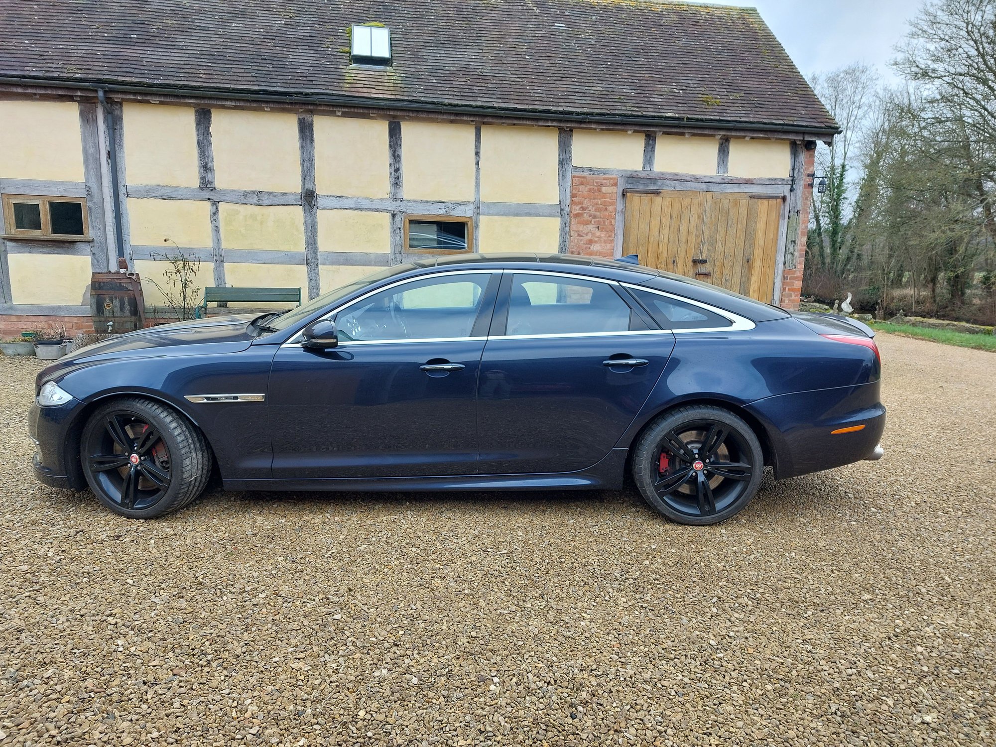

Nice! I have a IRR one with that exact same interior but that Blue is a sweet color!
What's it called?
I believe you also have the SWB version like me.
Is that CF or some kind of wood on the door cards? Mine is CF inside and out.
What's it called?
Yes it is a SWB and the colour is "Dark Sapphire". The door finish is "Piano Black". No CF anywhere!

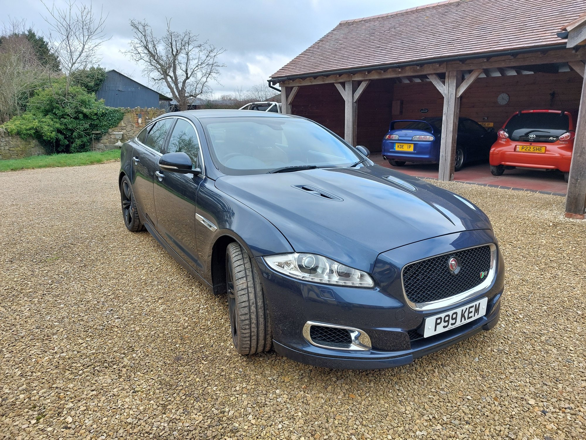

Yours is the only one I have seen in that color. Very unique car!
