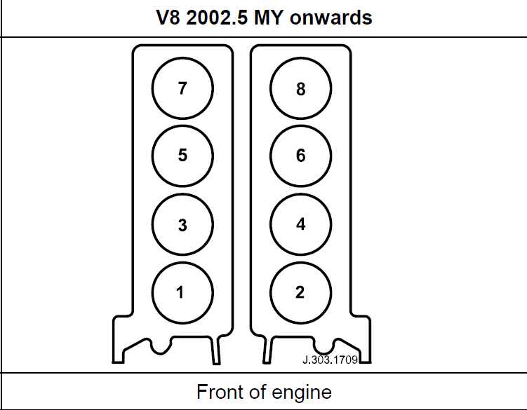

So you've changed coil for cylinder 3 ( Bank 1 ) and coil for cylinder 2 ( Bank 2 ). Now once it warms up, you get lean code for bank left bank ( Bank 2 ), should be P0174.

Attached Thumbnails 2004 XJ8 Left bank lean indication-04xj8cylinders.png   2004 XJ8 Left bank lean indication-04xj8p0174.png
