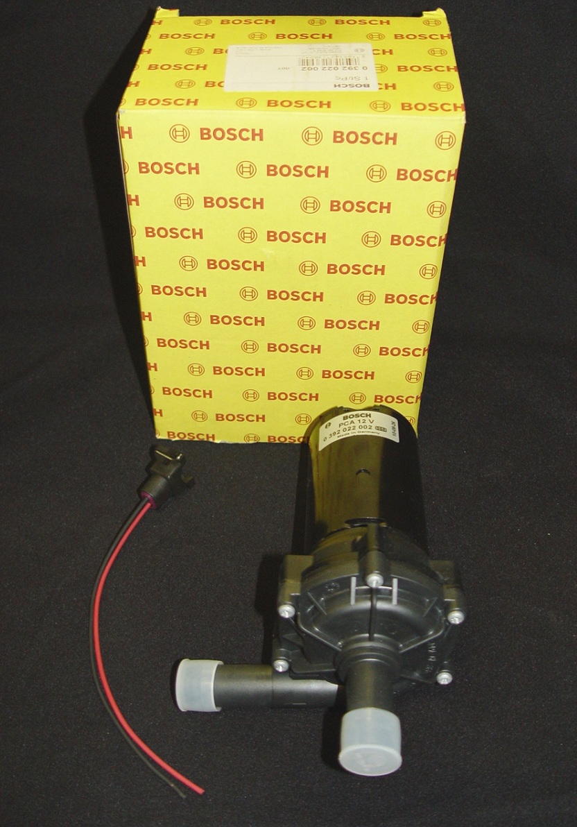

In addition to the Bosch 010 pump (about $100 cheapest I could find), you can order the 'connector and wire lead' from Titan Motorsports 877-251-6489
Connector wire part number: TMS BOS-WIRE $10 plus $8 shipping. Sadly, they are currently on backorder, expected back in stock in 2 weeks. I pre-ordered one today.

The 010 has the wrong type of electrical connector...the link I provided earlier for the adapter is the same size/type as the original harness. I ended up shelving the 010 and ordered the 002 which is a direct swap. Oh, direct swap... plus you need a new strap or bracket to secure it wether the old one was located.
