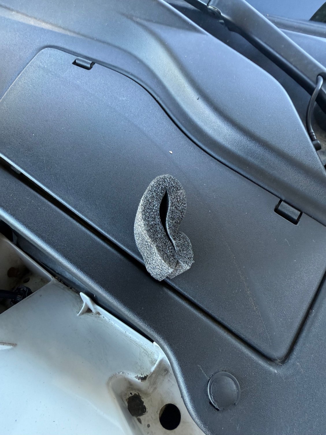

The foam I used is that split foam used for insulating pipes. You can get it at most hardware stores like Home Depot or other places. Here are the pictures you asked for.
Foam in tab openings
Push in insulation tab and foam into opening
Section of foam cut to width of opening
