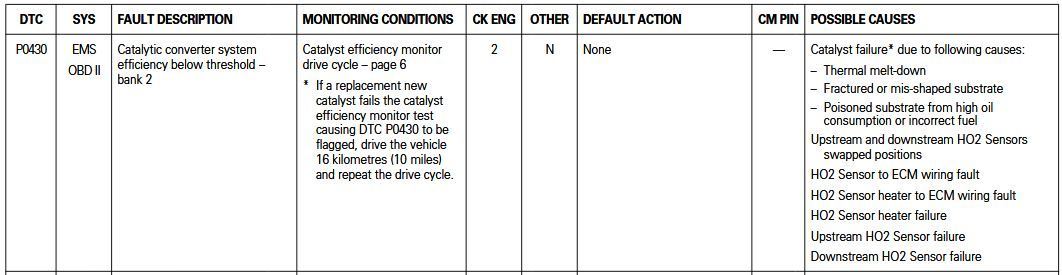

P0430 means "Catalyst Efficiency Below Threshold," and as JagV8 said it can be caused by a host of things. Here are the official definition and possible causes from the DTC Summaries manual:
A quick way to check your catalytic converter is with a touchless infrared thermometer. With the engine at full operating temperature, measure the temperature at the inlet end of the cat, then at the outlet end. You're looking for the outlet end to be at least 100 degrees Fahrenheit hotter than the inlet end. Be sure to aim your thermometer at the pipes right where they connect to the cat and not at the heat shields.
If both cats seem to be heating up properly, the next step would be to observe your fuel trims and O2S signals via Live Data on a scan tool to look for signs of a lazy or out-of-range O2S, lean or rich running, etc., and diagnose accordingly.
