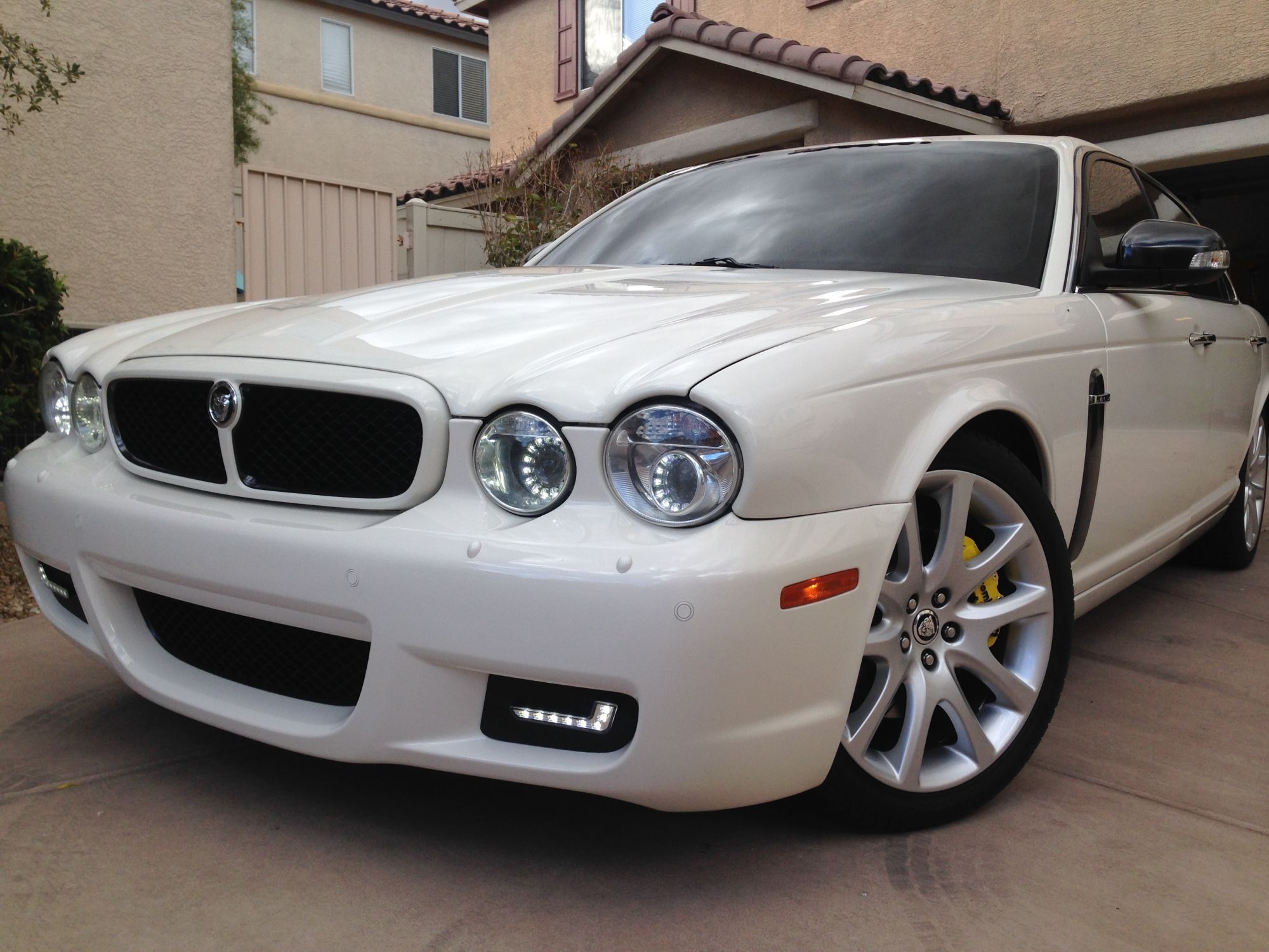

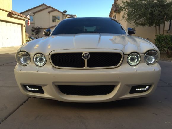

Don You are right the ballasts are mounted on the bottom of each headlight. However When they burned out on mine. I left them mounted where they are. And added the aftermarket ballasts. The wiring is right there i just test leads with a meter. However its not like I never removed my headlights as I did a full dual projector conversion with Crystal LED rings. With the x358 facelift now I know what you mean. It has to be different than mine. I have a buddy with a x350 let me see how easy it is to access and ill write back.
My high beams has a projector now as well. take a look at pics. I did everything you can possibly do to the lighting on these cars.
these pics are couple months old

Evan,
Your customizations make quite an impression! Nice work!
