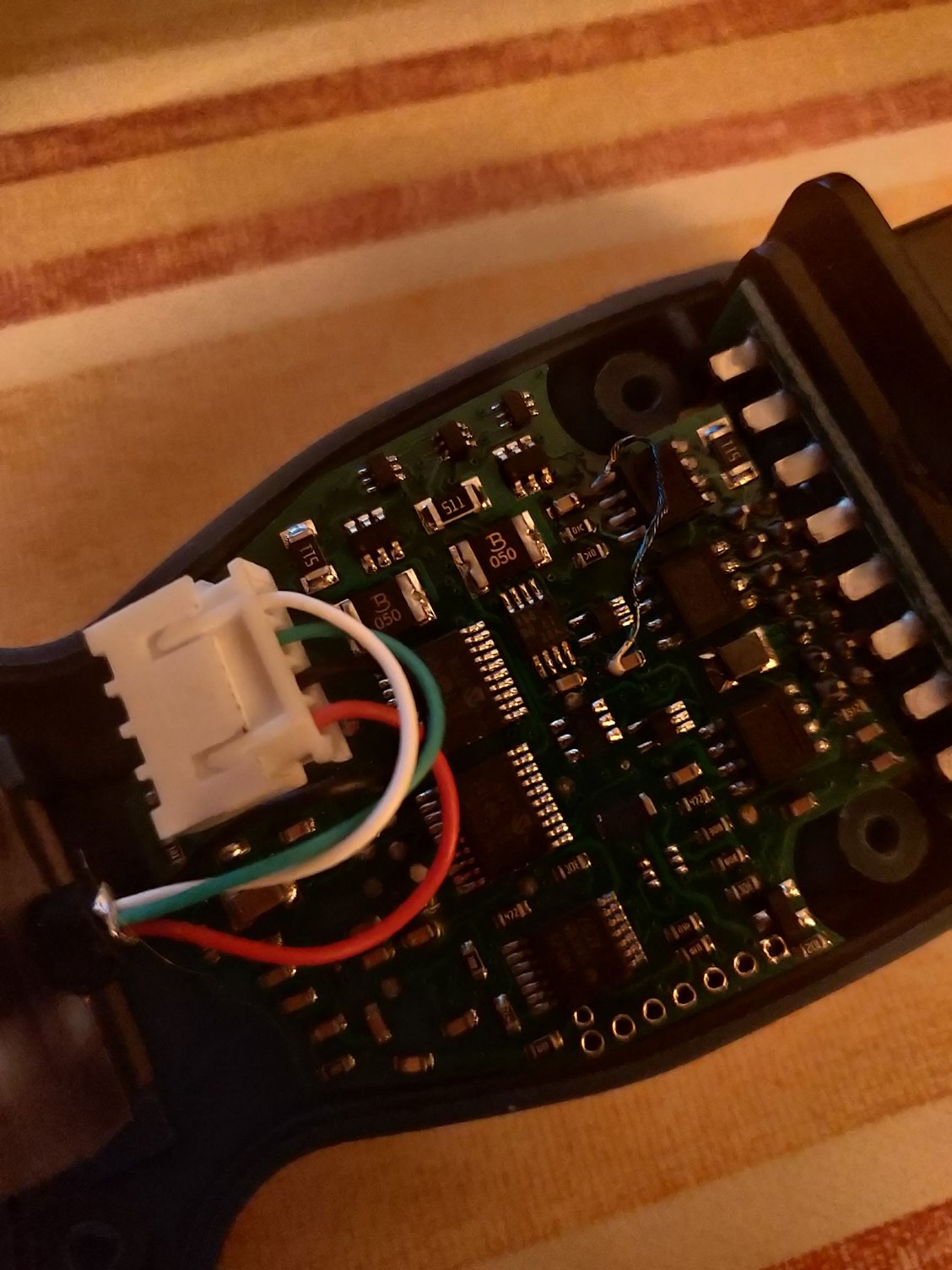

thank you for answer car it is a xe diesel 2015 it is ok for mongoose because the system changed in 2017 pathfinder . i opened the cable here are the pictures wires tampered wit
h in the printed circuit

Hi Alain,
ok, but then you are in the wrong forum. This is the forum for the XJ type X350/X356/X358, built between 2003 and 2009.
You will get more help in the correct forum.
