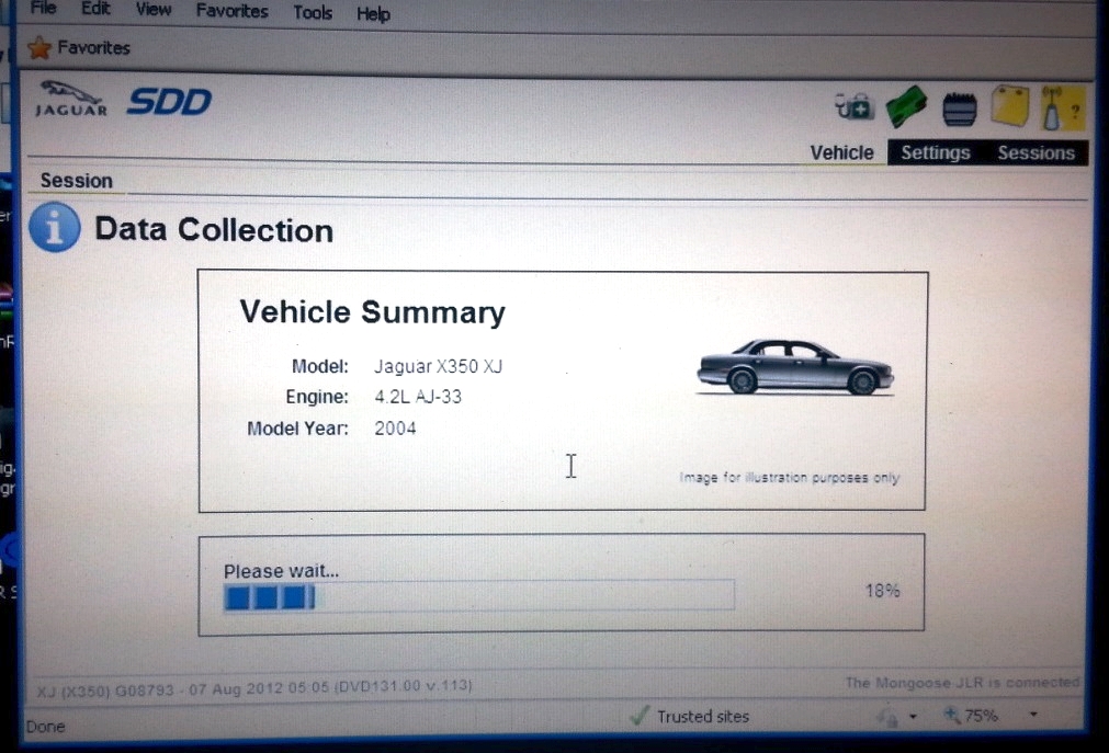

Originally Posted by reyesl
My SDD (134.04) indicates that I have an "Invalid VIN"? Have attempted several searches on the Forum to no avail. I am loosing my patience on this *#*# software.
Note: It will not let me enter the VIN manually and when I click on "Continue", it goes back to the "VIN search window" and repeats.
I purchased another clone copy (V131.00 v.113) and installed it on a Panasonic CF-29 Toughbook. Several hours later, and after connecting my battery tender, everything is working fine. I used it to troubleshoot the transmission and brake problems my VDP had for several weeks.
