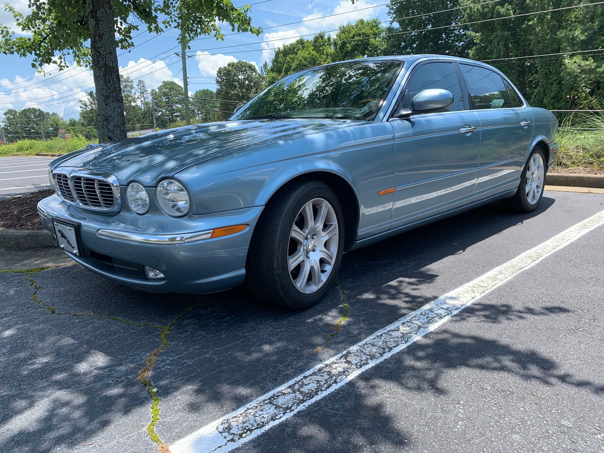

2005 XJ8L
Hello everyone!
Since this is my first post let me start with thanks to all that make this forum possible: Thank you very much!
I need advice with a minor (yet) issue I noticed on my (new to me) 2005 XJ8.
In 3rd and 4th gear I noticed a slight RPM fluctuation if I keep the acceleration at/around 1500.
Does not happen unless those conditions are met. What can it be and where should I start looking at?

Welcomm to forum!
Gourgeous JAG!

Love the Jag in zircon
Blue zircon
Zircon is available in a rainbow of colors. Reddish-brown earth tones are common, but bright red or green gemstones have higher market value. Blue zircon is the most popular variety. It comprises 80 percent of all zircon sales and commands the highest prices.

Zircon is a favorite color for sure!! Just beautiful.
