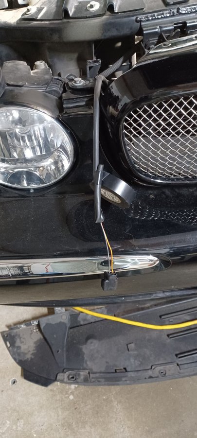

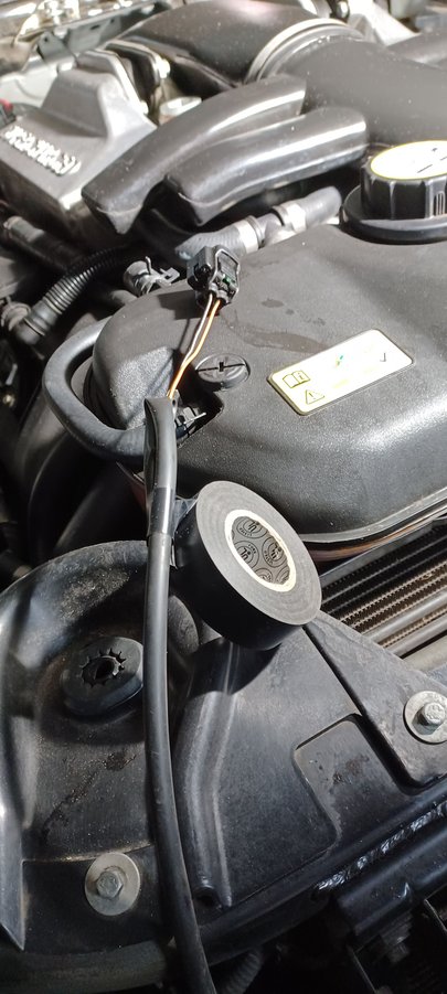

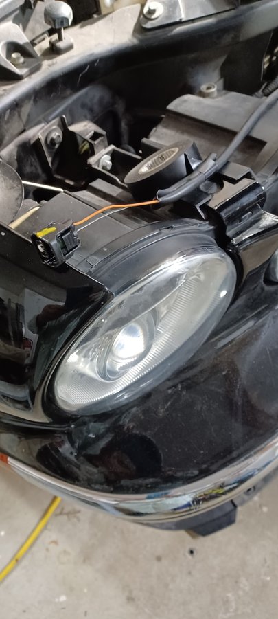

As I was preparing to put the radiator cover back on, I discovered a plug that I have no recollection of unplugging nor any pictures of it being unplugged. Could this be for a headlight washer if I had one? Or is it for something that I can't find? I was hoping that it went under the fuse box on the right & that it might fix the ACC issue. Then I thought that it might be for a fan motor or sopmething. Searching with the endoscope in the radius range of the wire yielded nothing. I think I explored the underside of the fuse box sufficiently and saw no unused receptacle.
It originaters from the same wire as does the large plug for the headlight assembly on the right side.

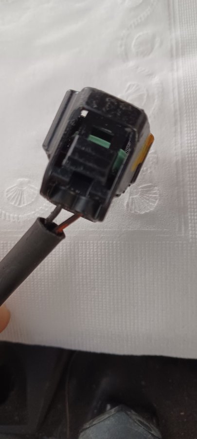

You could pull back the black cover on the wires and note the two color codes. That would narrow down your search. Could it be the plug that attaches to the airbox to open the extra air flap at WOT (wide open throttle) ?

Thanks, Guys. The plug is on the passenger side (U.S). The air box is wired & on the driver's side. There are 2 wires: 1 is orange with white stripe; the other is black & green & white striped. The length of wire from the feed is 17"; it originates near rhe wire to the headlights, I was not able to find any writing on the wires. The photos, I hope, will show where the wire is. Thanks & have a great week! Steve S.

Could it be the plug for the temperature sensor that you had asked about in one of your threads when dismantling the car?
It was part of this thread:
https://www.jaguarforums.com/forum/x...access-281433/
You asked "was ist das" on 06-25-2024.
Best regards,
Thomas

Thomas, you have a mind like a steel trap! Thank you.
Reconnected the shock tower & taking a little break. Will drive her around town without installing cabin filter, etc. Will unbutton the under the bumper cover to plug in the temp...
