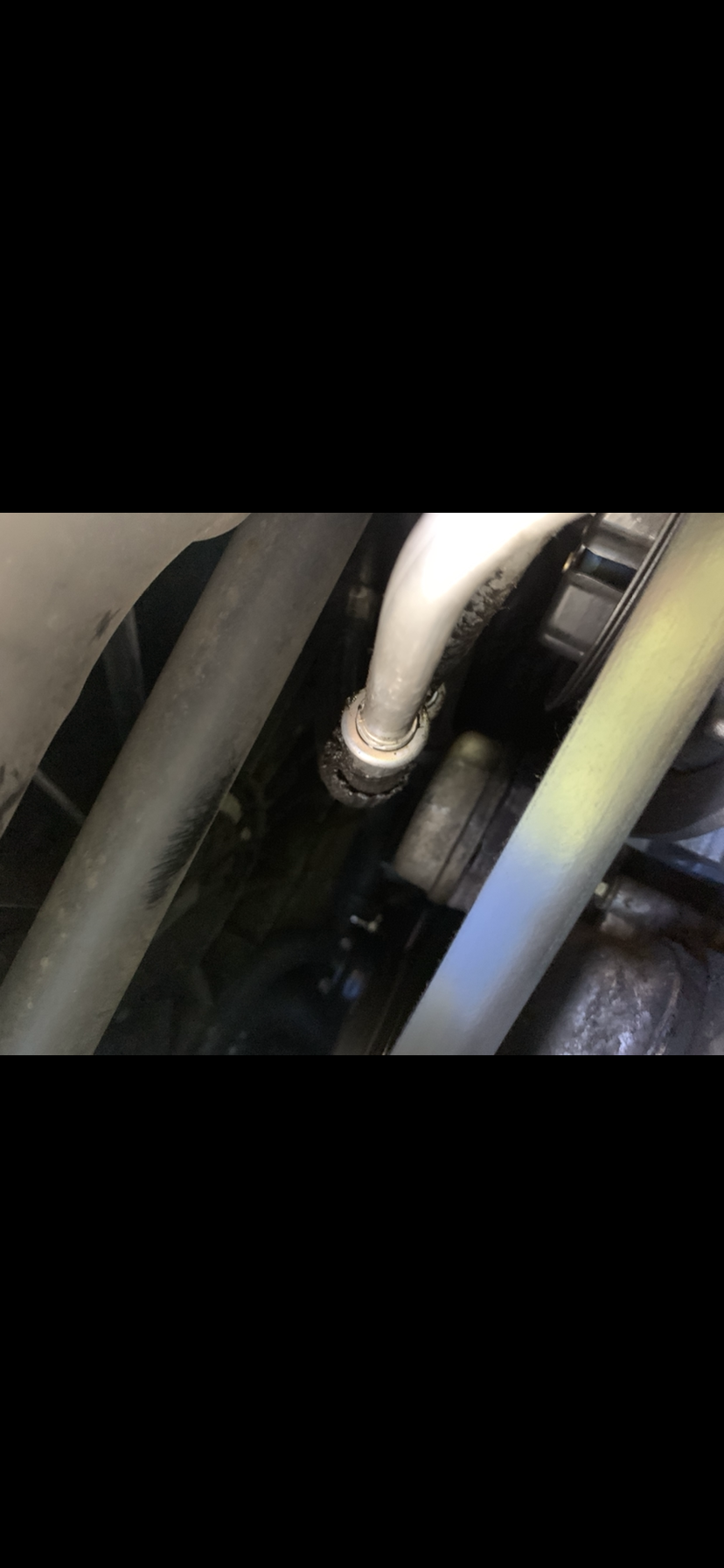

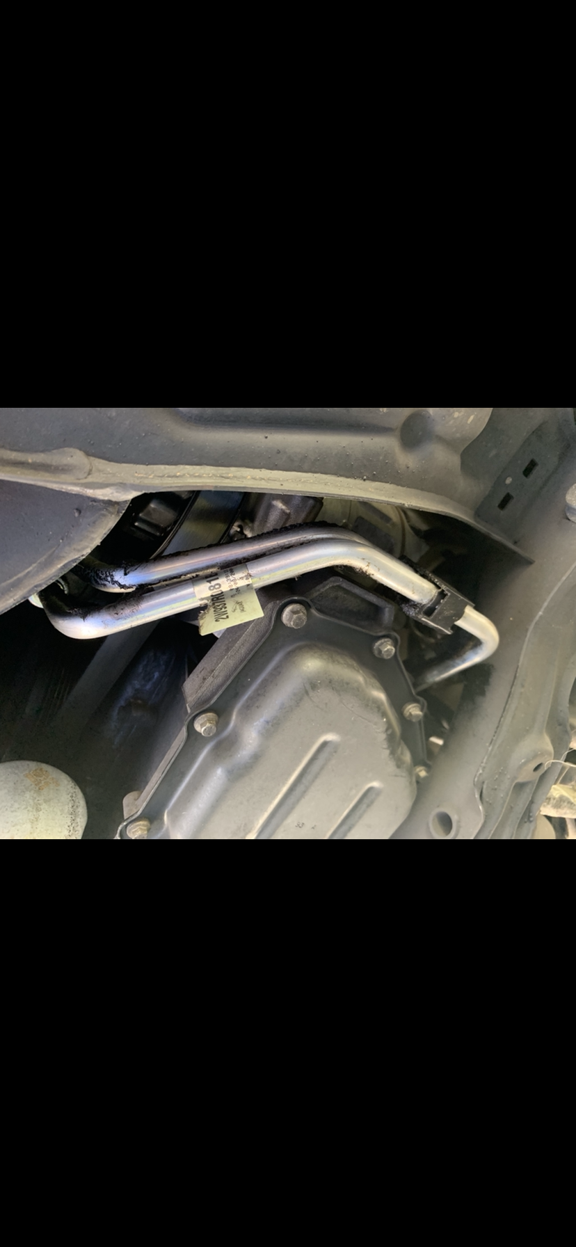

Hello all, I am the new owner of a 05 x350 Lwb! I love it so far and have a couple issues to deal with but one is this leak! It’s under car right next to the oil pan and I will attach pictures! It has leaked a puddle the size of like a shirt. I believe it’s the transmission cooler lines and have been reading about the repair. Could someone else help me identify that it is the tranny cooler lines?
any help identifying or advice on the issue is appreciated thanks!

Yes, those are the trans cooler lines and if they are leaking that much you have to remedy, quickly or risk burning your trans out!!!
Common ussue.
Lots of info here. Both replacing with new lines from Jaguar and how. (ROYAL PITA) or much better, stronger, long lasting, permanent options that can leave most of the lines in the car.
Read up here!

Best bet is to leave aluminum lines in situ. Carefully cut off crimp shells, and replace flex sections with 1/2" ID trans cooler hose, double clamping to ensure no leakage.
I'm about to do this on my XJR, which is undergoing valley hose replacement. The flex sections on my car are just beginning to seep.
I plan to use a dremel cutting disc. Access to lines is eased by removing air filter box and lower radiator hose. You can do this with ramps, etc
Do a forum search, and you'll find pics of the process.
Note: I do not recommend cutting aluminum lines. Just remove the crimp shell. This will retain hose barbs, plus make repair sections secure and of appropriate length
Hope this helps. PM me if questions...

What I do not see on those cooler lines is any evidence of transmission fluid. They look pristine clean.
Aslo you are describing a substantial leak! How long has it been going on?
Leaks nearly always occur at the crimps as the rubber shrinks over time inside the crimp.
It is a royal pita to replace them so if you can do as suggested above that would be good.
I replaced mine because when I tried cutting of the crimp I could not do it successfully. It is not as easy as it sounds.
