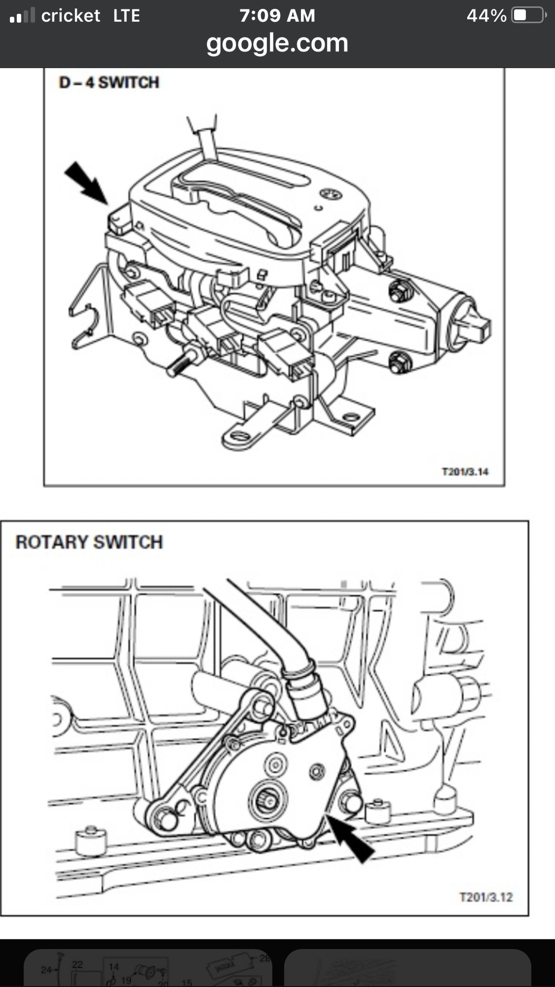

my husband and I took out the center console and in the gear box there is a black plastic circle around the shifter that slips off some times we took off the knob it twists off

Could you post a picture of what you mean?

[QUOTE=Thomas-S.;2804159]Could you post a picture of what you mean?
Thanks!
Best regards,
Thomas[/QUOTE sorry, took so long. I was actually doing some work on our jag. But it’s the second half of the picture

Could it be that the picture of the shifter you posted do not show the shifter of the X350, but the one of the X308?
It looks different to the shifter of my X350.
Best regards,
Thomas
really? It looks like mine I have a 05 xj8L
