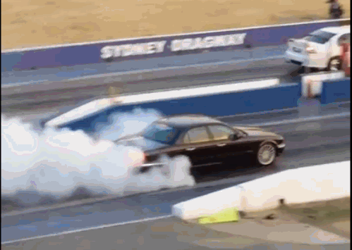

Originally Posted by trosty
Good luck with the racing. Any pictures or does it still look stock from the outside?
Looks stock on the outside. I'll try to get some photos today once I wash all the rubber off the back of the car
