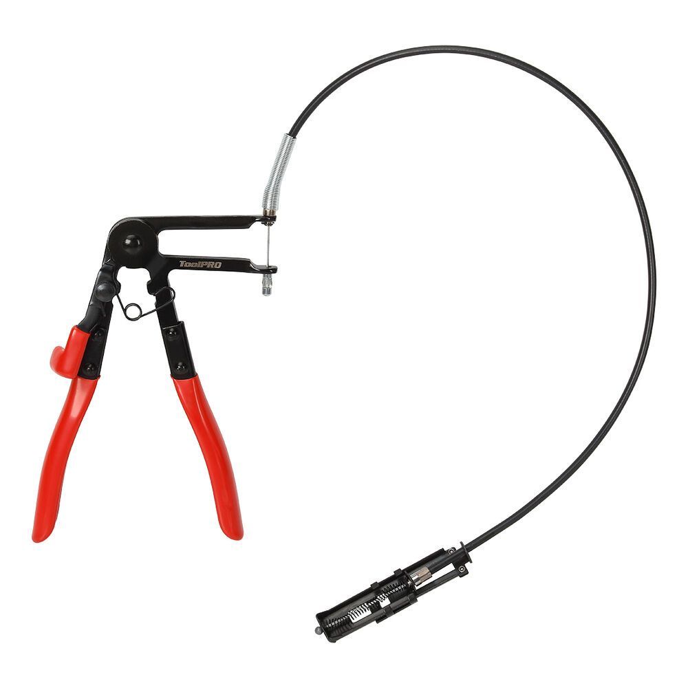

If you are hoping to work on the cooling system, then a remote hose clamp plier like the one below will be very useful.
Remote hose clamp pliers
Pete M

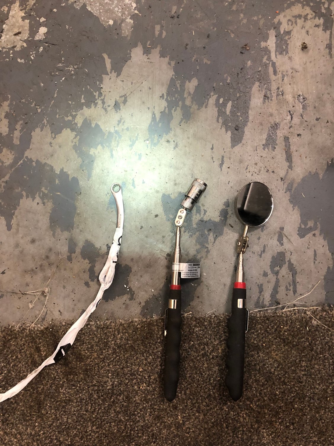

+1 for tools that enable you to work in tight spaces, for example while working on the rear axle where the fuel tank is in the way.
For the Jag, I have bought "ratchet spanners", as I would call them, both with fixed and rotating ratchet sides, please refer to the pictures to see what I mean.
One of the best purchases ever, I use them a lot on all of my cars.

Best post of the day thank you, I am trying to remove my EGR valves and struggling to get a bolt off- these have to be worth a try
