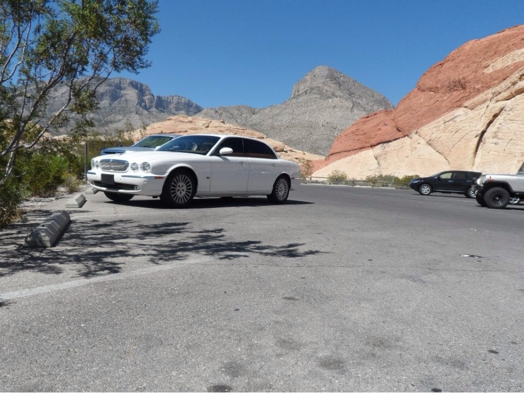

Anyone go aftermarket and keep with an 18" size? I was looking at 19"s and tires are considerably more affordable for 18"s and 20"s, but I have no interest going the way of the super low profile tire for the cheaper 20". I've done enough of that in the past and have no interest in ruining my ride quality. I am just not a fan of overtly obvious non OEMs and I don't care much for the factory 20? spoke wheels my car came with. Coventry seems to make nice wheels that with Jaguar center caps attached look darn near OEM, but I've only seen pictures of 19"+ wheels on XJs from them. Anyone have pictures/wheel suggestions that would accomplish what I'm after? I'm not trying to keep my current tires. I am buying new tires and think I'd still prefer 18"s. Even if the factory center caps don't fit, I'll be able to fabricate something from my current caps to work. I don't mind 20 spoke wheels, but the factory ones just look so flat and don't have a lip to define them.

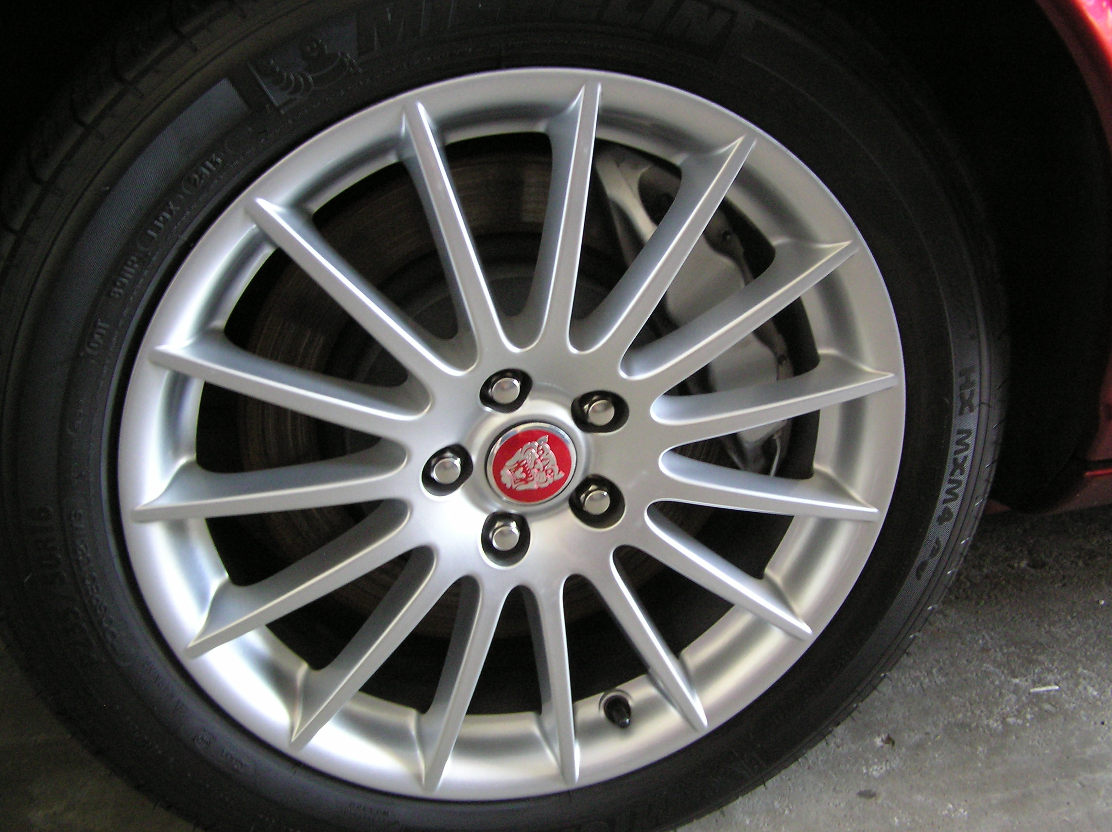

Mine is an 05 and I put Tucana 18" on mine. Fit just fine and are jaguar so I just swapped the center caps.

Those look great. I wouldn't know from looking at it that they weren't the original wheels. Exactly what I'm going for.

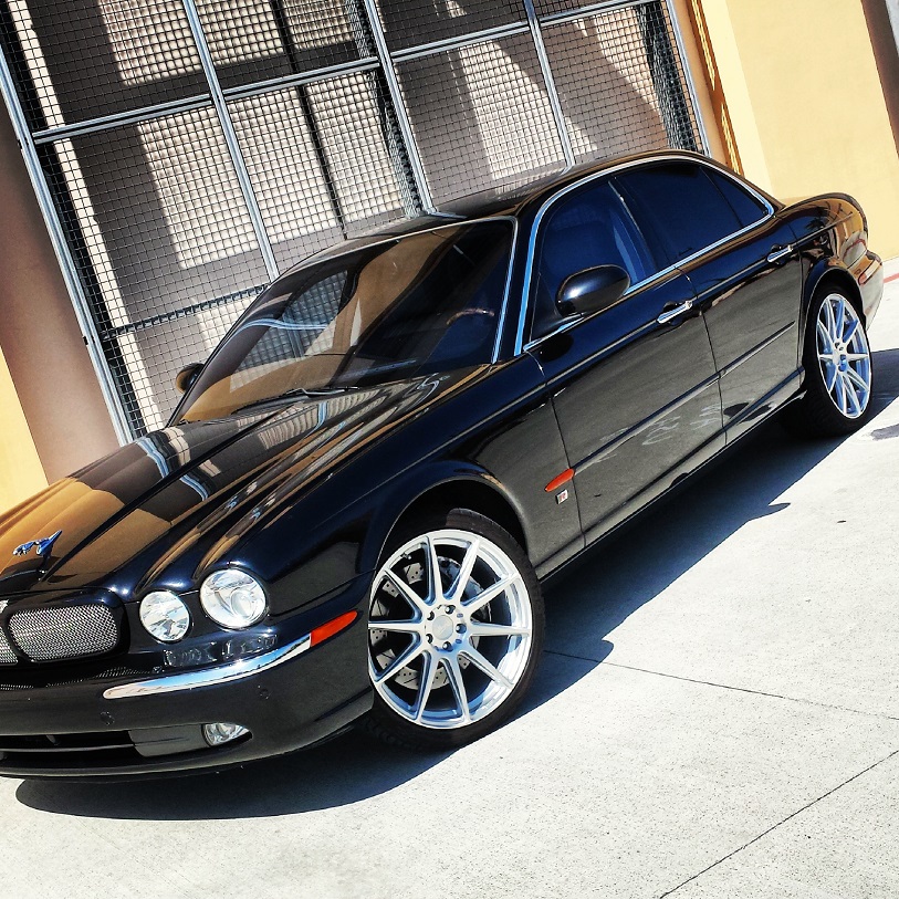

I have the 20" XKR wheels + spacers

How does it affect the ride? They look excellent, I'm just concerned about going up to a 20".

I feel every bump, even with air suspension

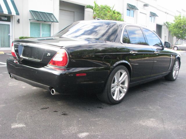

I'm running 19x9 and 19x10 Tobias (stock '10+ XJ wheels) on my '08 XJR (without spacers) and they look really nice (gives the car a good M5 stance, which on a black R fits it perfectly IMO). Ride is really reasonable as well. 275/40's in the rear and 245/45 up front.

Is there a reason you didn't go with 255/40/19 in the front? Isn't that the factory 19 size?

Not sure actually, they were on the wheels already?? I think even with slightly wider rubber, a spacer up front (5-10mm) would look much better.

Do you know the offset of front and rear wheels? Any rubbing in the rear with the 10" wheel?

Unsure on offset yet, but no rubbing, they fit great:
