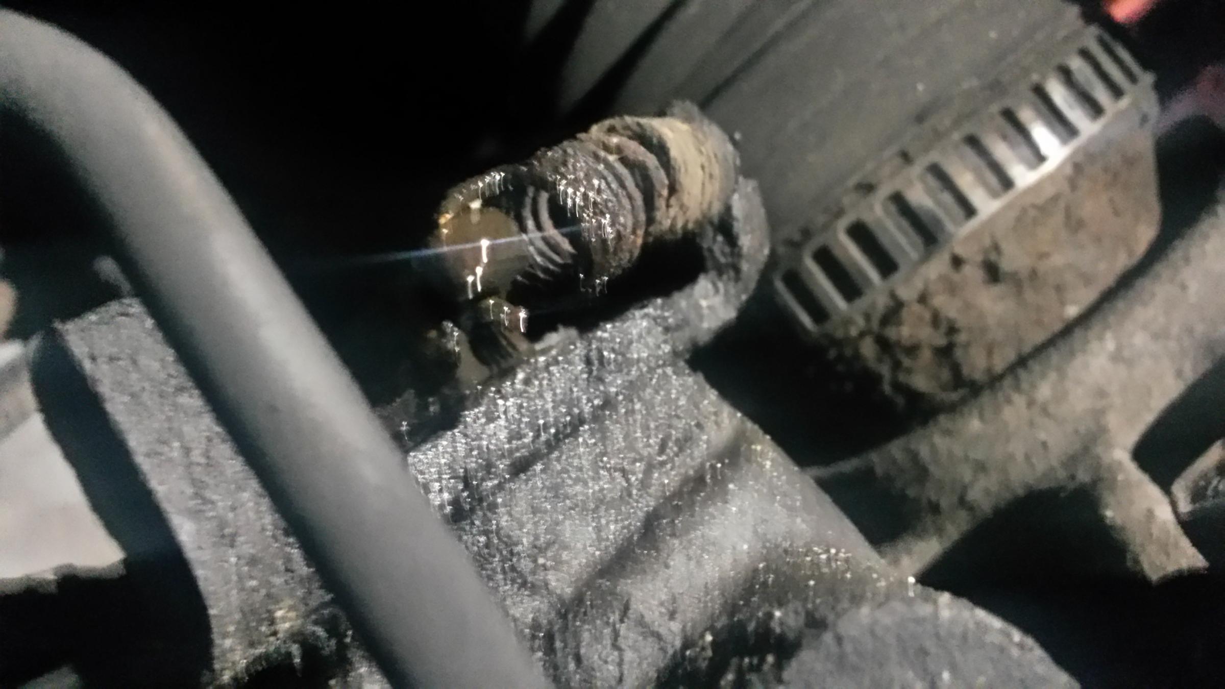

Old Dec 8, 2014 | 02:26 PM
Matthew Barden's Avatar
Joined: Jan 2013
Posts: 75
From: south of france EZE
Default I have found the leek what next...............photo attached
good news we are closer to fix the leek...........
I have attached a photo of the caliper rear right hand side drivers side after looking for the price on uk jaguar £320 later but before i go down this route i would like to know if i can just change the seals which is where the leek is coming from, dripping from the spring just behind the piston.
thank you and every one that helps me get to the bottom of this.........
matthew barden
XJ 350 2004 3.0L amazing car
Attached Thumbnails Where is my brake fluid going ?-20141208_172535_lls.jpg   Where is my brake fluid going ?-no12134_c2c41568-upload2.jpg

Originally Posted by oldmots
I doubt that the booster could suck in brake fluid, if it could, it would cause a vacuum leak in the intake. The more likely scenario is that there is a loose or dodgy washer between the brake hose and the caliper.
i think you are right i have taken a picture of the leek and hope you can help me all the best matthew

" i would like to know if i can just change the seals which is where the leek is coming from, dripping from the spring just behind the piston."
Used callipers are avilable on E bay

You can also buy rebuilt calipers at most auto parts stores; at least here in the states. they basically clean them up and put new seals in; much cheaper than buying from Jaguar.
Also I can fly stuff from England so just the delivery cost which still works out much cheaper than France...

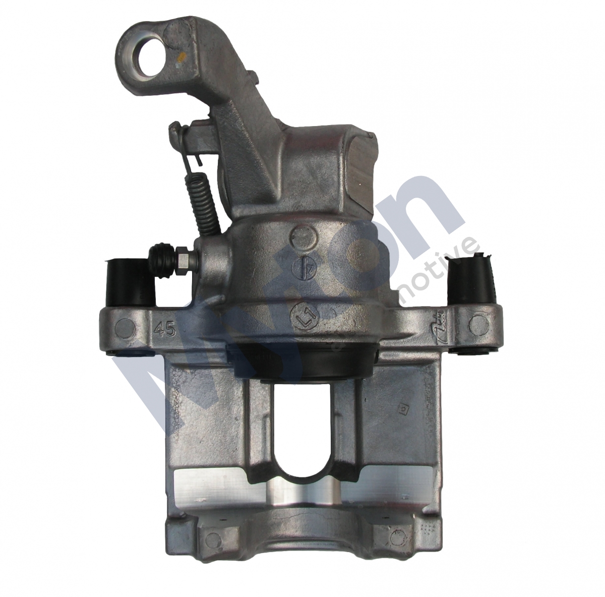

Seal kit:
Jaguar XJ Type X350 Front Brake Caliper Repair KIT 3856 | eBay
Just checked and you need rear seals but I am sure vendors can help.
