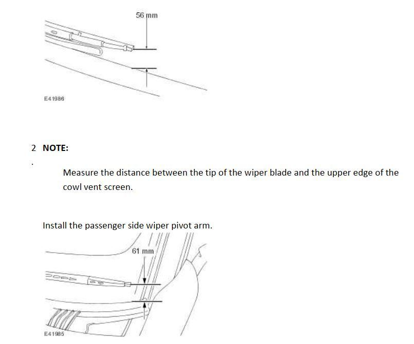

Hi jagxjr,
Here is the picture from the manual for the correct wiper positions. Loosen the nut holding the wiper arm, and move the pivot end of the arm until it is free. There are no serrations, it is held by friction. Adjust the arm to the correct position and tighten the nut. The picture is for a RHD car, flip it for a LHD car.

Thanks Pete for your answer.
Wipers start acting like that from nowhere without changing standart sizes of blades.
Im not sure how to read and follow your diagram so I would have to ask mechanic.

Hi jagxjr,
I have heard of wipers doing strange things if the earth points behind the headlights are corroded. I had an experience of my left headlight flickering badly. When I checked the earths, one had unscrewed itself a few turns. Tightening it (very carefully) solved that problem.
Are your wipers set to the Intermittent position on the stalk (one click down) and Auto on the stalk knob? If so, try turning them completely off and see if they start moving by themselves. There are a number of threads about this that may help. The diagram just shows how far up the screen the wipers should sit when they are switched off.
