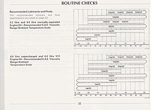

I've mentioned before that the "old timer" mechanic at my local Jaguar dealer that does all the service on the older cars recommends 20W50 all year in our area where temperatures normally range from 10-20F to 100F.
He says the AJ16 is not much different than the the previous AJ6 which specified 20W50, and Jaguar began specifying lighter weight oil with increased fuel economy requirements when the AJ16 came out.
He saw quite a few issues with chain tensioner rattle when owners stuck with the lighter weight oils, especially in warmer climates and also especially if they didn't use the OEM oil filter.
I've done quite a bit of testing myself with oil weight and non-OEM filter combinations, and in my experience it appears he is correct. For me 0W40 oil for example will cause the tensioner to clatter in warm weather.
But even if one doesn't feel comfortable with that recommendation, the attached table shows that 15+Wx is good down to freezing, and 10W is good down to -5F.
YMMV
