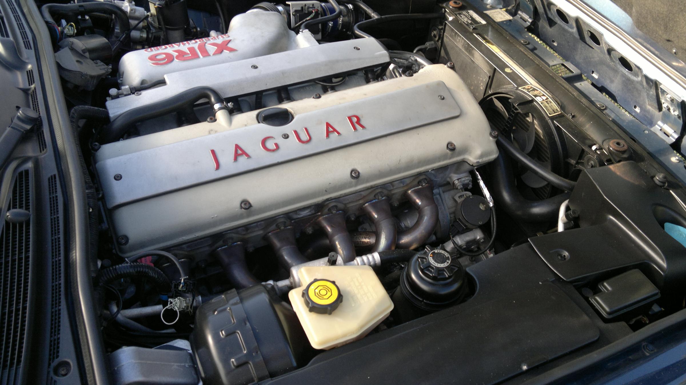

I removed my air pump when I had the custom headers and exhaust made for my XJR6 never had a problem
