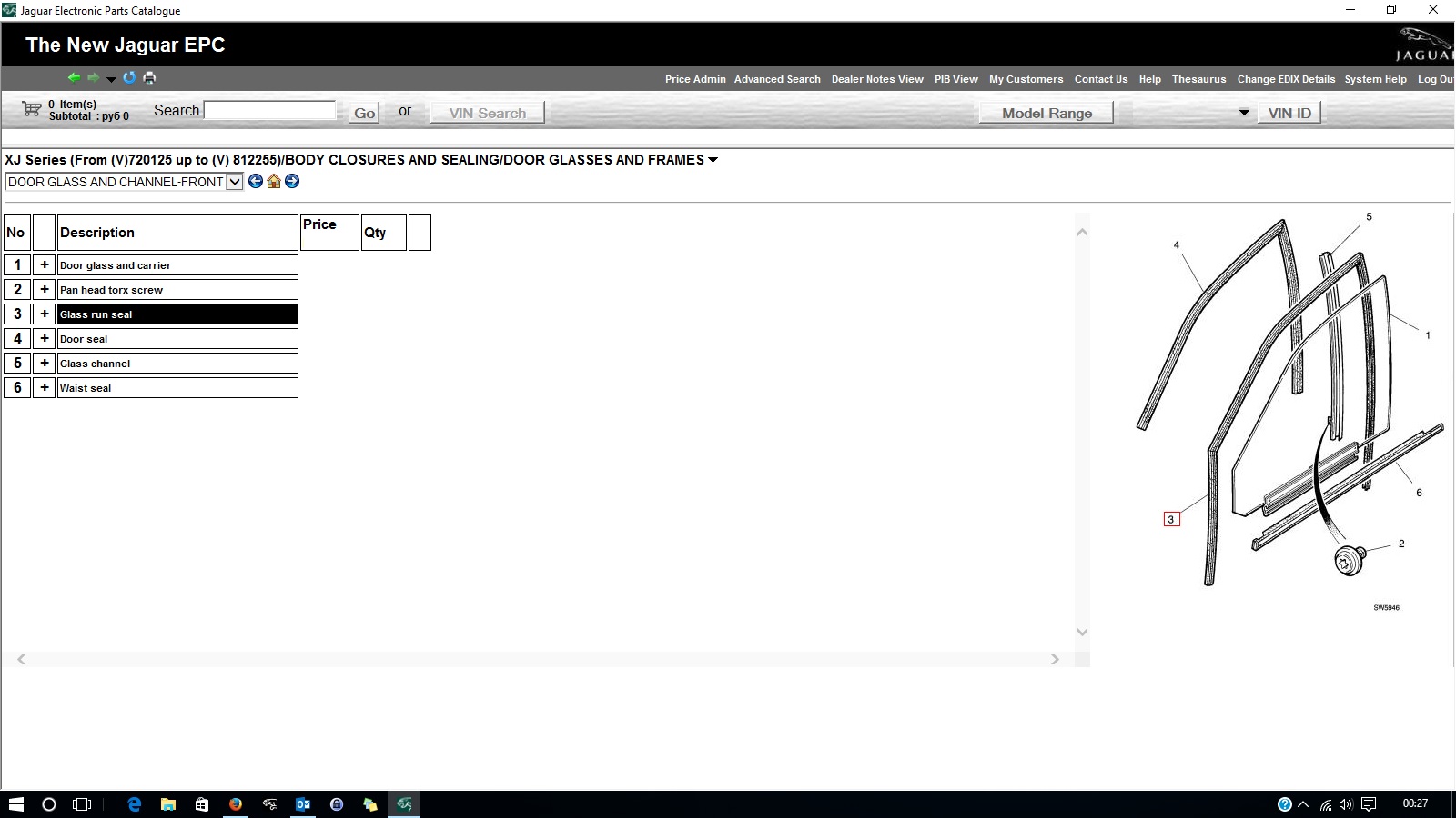

Welcome to the forum crvols,
Is it the Glass Run Seal (item 3)?
Trim items are usually the first to disappear from Jaguar inventory but these appear to be still available from Jaguar Classic Parts:
Door Glass and Channel-Front - Parts For XJ Series from (V)720125 to (V)812255 (X300) | Jaguar Classic Parts UK

I think crvols is talking about the 'INSIDE version' of #6 waist seal.

I just double-checked the Electronic Parts Catalog and I think Part 6 is the inside waist seal and if I understand crvols, it is the part he is describing.
The EPC indicates that the part numbers are different for each door (Front/Rear & Left/Right), and vary depending on finish and the VIN of the car.
crvols, if you'll post the last six digits of your VIN we can look up those part numbers for you, in case they will help you track them down.

Motorcarman is correct, No. 6 in the diagram is definitely the Outer finisher seal.
I know for sure as I bought a full set a few years back. At around £400 for the set of four it's the most expensive rubber seal in the world.
