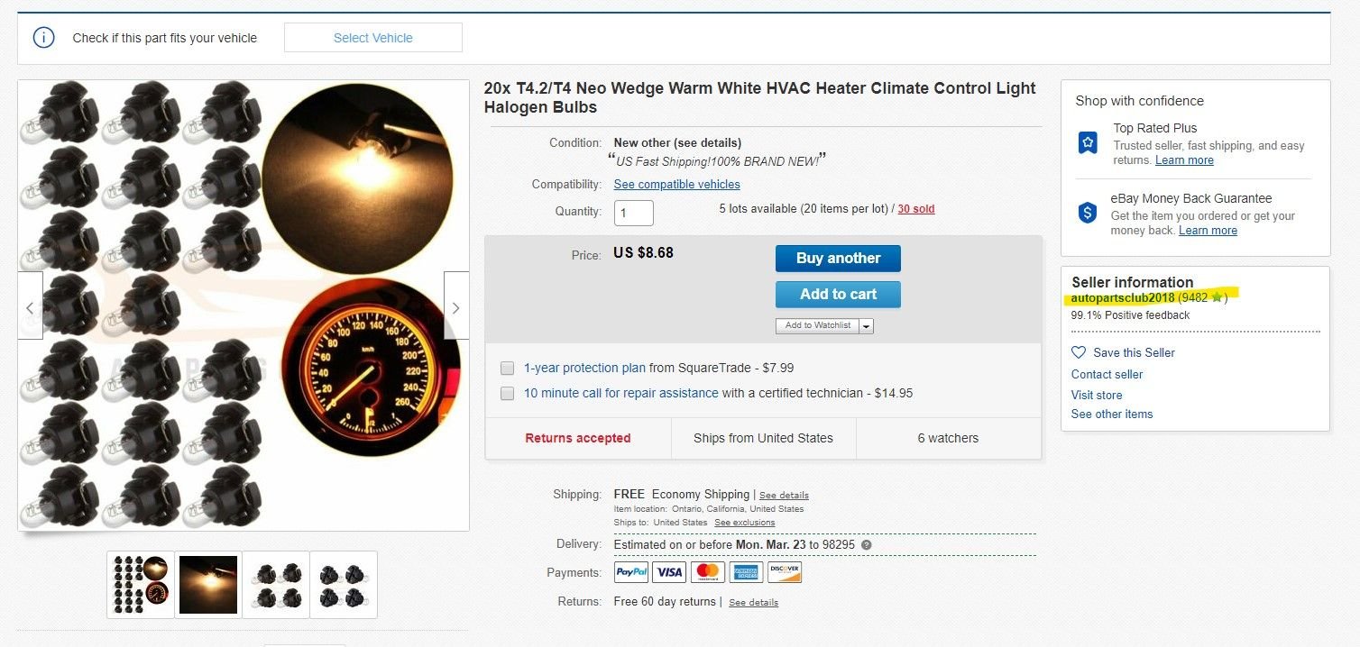

I got these from Ebay (eBay item number:223657838464).
They did not fit as tight as I would have liked, so I removed the bulbs from the black plastic holder, and soldered them directly on to the board. Works perfectly.
