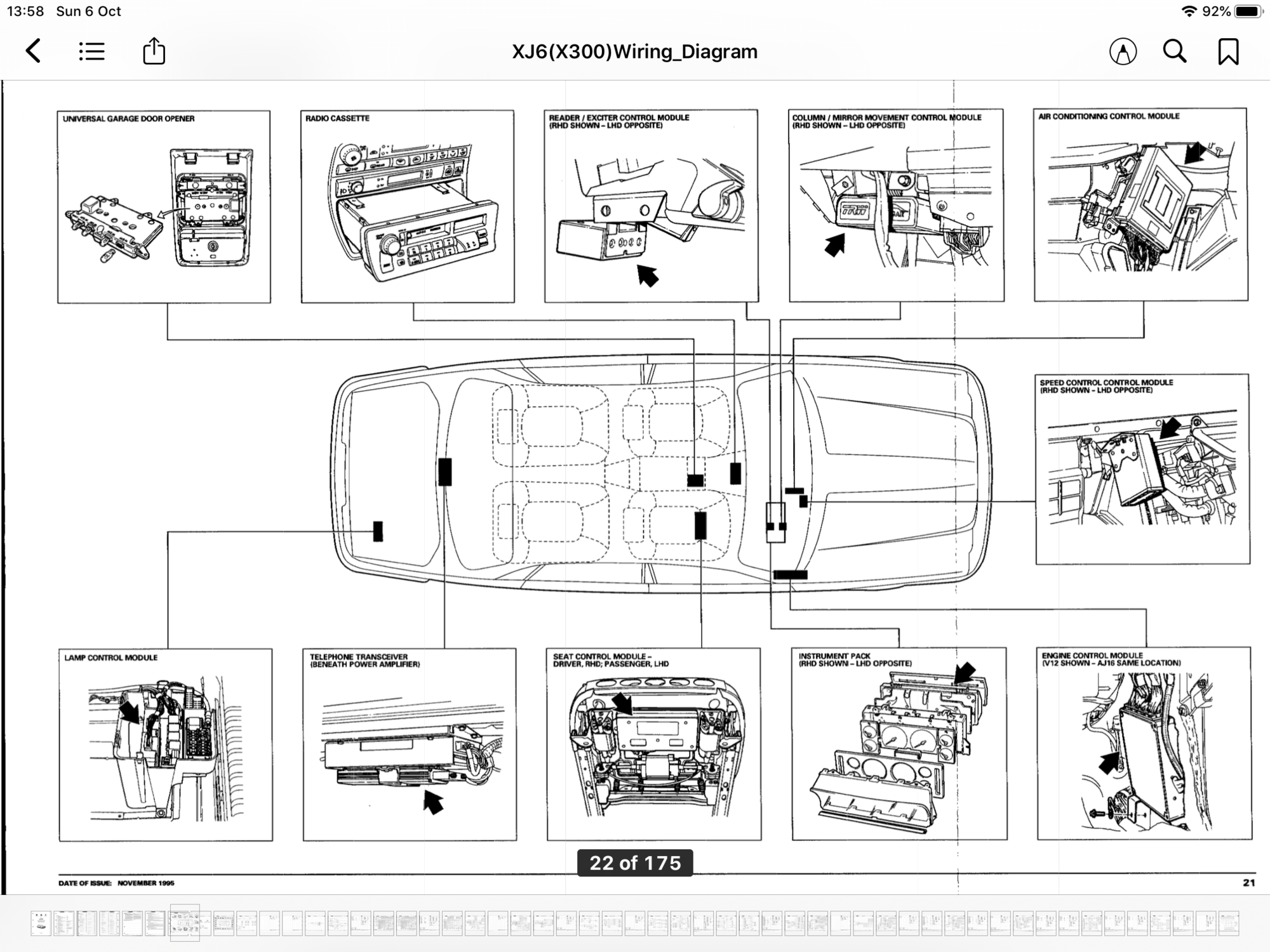

According to the wiring diagrams, module is located on the RH side of the air on unit under the dash.

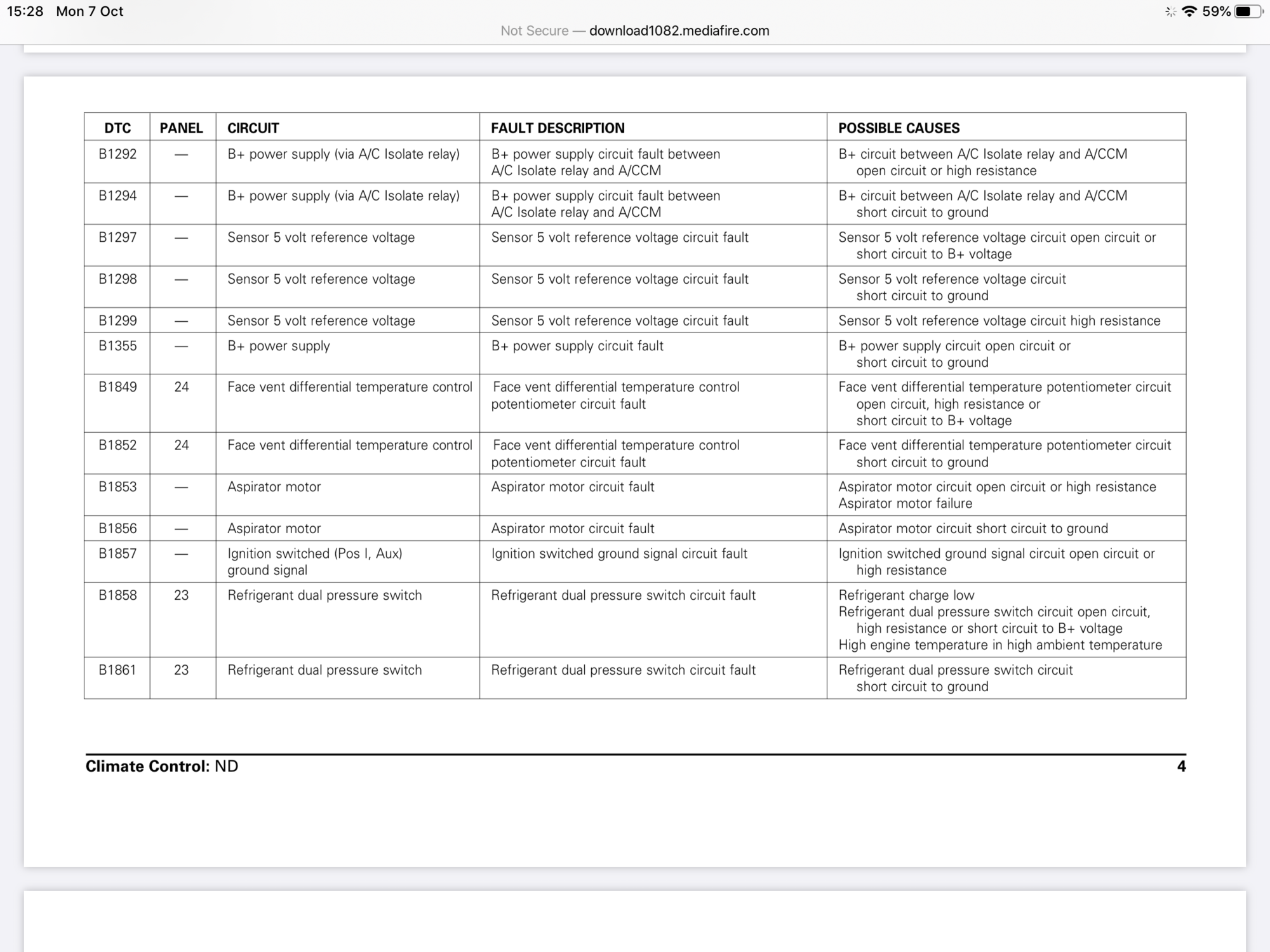

The error 23 is a refrigeration switch error (according to the site) X300 Air Conditioning Self Test and Diagnostics ~ Jaguar Vanden Plas "The cats meow"

The 23 error can also be that there isn’t enough gas in the AC.
I would take the car to AC specialist for a re-gas incase thats the problem, and they can check the switch operation.

Has anyone replaced the main Climate Control Unit, not the control in the centre console, and if so, how easy is it to do?
