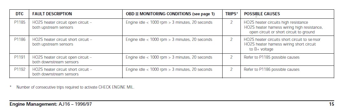

Old Apr 13, 2018 | 04:09 AM
Likes: 17,008
Richard,
Here is the relevant extract from the Jaguar DTC Summary list for the four codes. See 'Possible' Causes' in the right hand column.
The MIL is illuminated because trigger values have been exceeded and not because the vehicle is about to grind to a halt.
As you have already replaced the HO2S, this takes a leap forward in the logical troubleshooting sequence but at 132k miles, replacement sensors is not a bad investment.
1. the chance of all sensors failing together is extremely low.
2. the four DTC's suggest a harness fault as the more likely cause.
3. The new sensors eliminate heaters or harness to connectors as possible causes.
4. the same multilock connectors are used by Jaguar in several applications on many models and are a frequent cause of harness faults. However, this is more likely to affect a pair of sensors rather than all of them.
5. a ground connection fault is more likely to affect all sensors.
