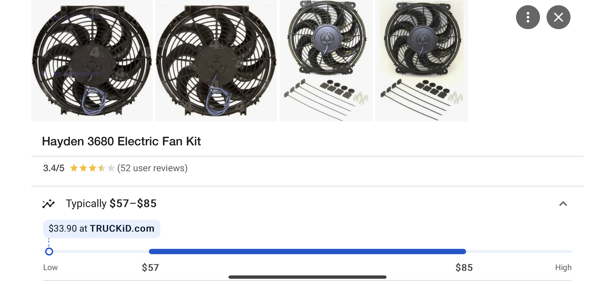

sorry, i meant these generic aftermarket ones you mount in the radiator and wire in as pictured below. But after reading a few threads in the forums (believe you replied to a few of the threads I was reading) about high and low speeds and them running series and parallel I decided it’ll probably be best buying a used and hoping for the best.

I don't think the aftermarket 'generic' fans are a direct fit.
I guess they can be fitted with some work?(modifications?)
Would have to forgo the whole shroud and use those pins through the radiator fins to mount it (unless I could figure out a way to attach it to the shroud) and cut the pigtail off the harness and wire it directly. A lot of butchering. Definitely not ideal.
